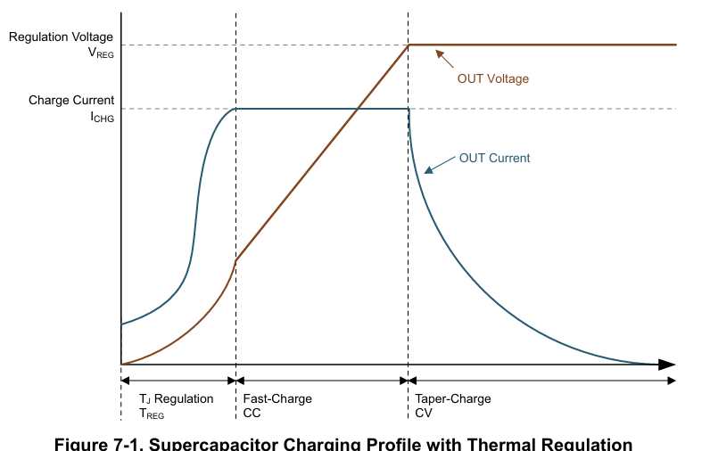

I'm using BQ25173DSGR charger in my design to charge 0.47F super capacitor to the maximum voltage of 1.4V with the configured current limit of 30mA. From the datasheet it is understood that super cap will be charged by a constant configured current of 30mA, when charging the SCAP from 0V. image.png
But I couldn't see this kind of behaviour. It looks somewhat strange.
With my understanding the theoritical charging time of supercap from 0V to 1.4V would be 23 seconds, but we are observing the sudden change of super capacitor voltage from 0 to 1.4V in 341us.

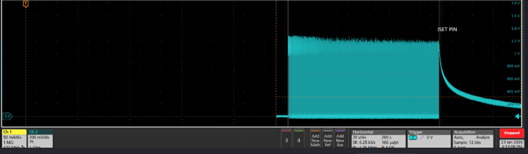

    Scope captures:
    Super capacitor's voltage during charging
    For our understanding, can you pls explain how charging will be done for completely drained supercapacitor and how much time it will theoretically takes for complete charge to 1.4V.
  • Any other relation to output current with voltage on ISET PIN other than below
    Scope capture:
    Super capacitor's voltage during charging:
  • The ISET pin is a sample of output current at a ratio of 1 to 300.  The ISET current develops a voltage across the ISET resistor, at 1V the unit is in current regulation.

    Can you please suggest what is the expected charging time of the super capacitor in my case and typical test waveform that you have for our reference?
  • Hello
    "Can you please suggest what is the expected charging time of the super capacitor in my case and typical test waveform that you have for our reference?"  -- The expected charge time I calculated is about 22 sec.
    I have tested a similar configuration using the BQ25173 EVM with 0.5F capacitor configuration.  The charge current was 34mA with charge time was about 19.5sec.
    The lab test did not show any charge problem for this configuration.

    UPDATE -- In the below test I measured output voltage with a DVM and it is running 1.3698V
    Can you share any charging waveform captured for charging 0.5F in your lab.
    See below scope capture of a start up in your configuration.
