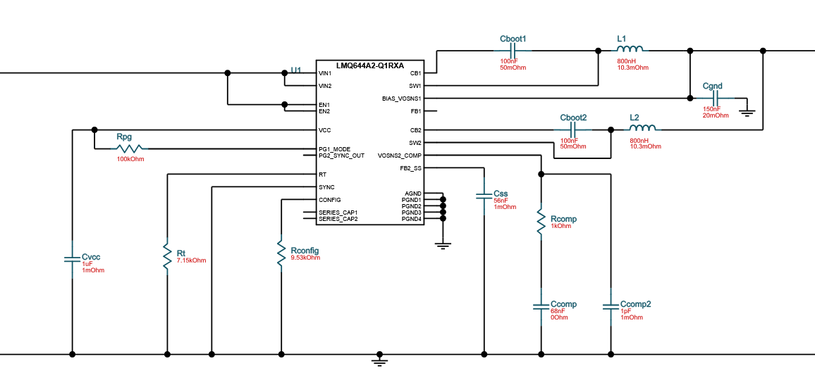

I tried to model this component in Webench:
Output Type: Single, dual-phase
Input: 9 - 16V
Output: 12A max @ 3.3V
1.) The resulting schematic shows FB1 being left open. Why is not being tied to ground, as per data sheet instructions for a 3v3 output? I don't know if I can trust anything else being showm in the schematic now.
2.) I need correct compention component values for a device beign configured as a single output 3v3 and another device being configured as a single output 5v. Both devices will have 12A outputs (6A per phase)
