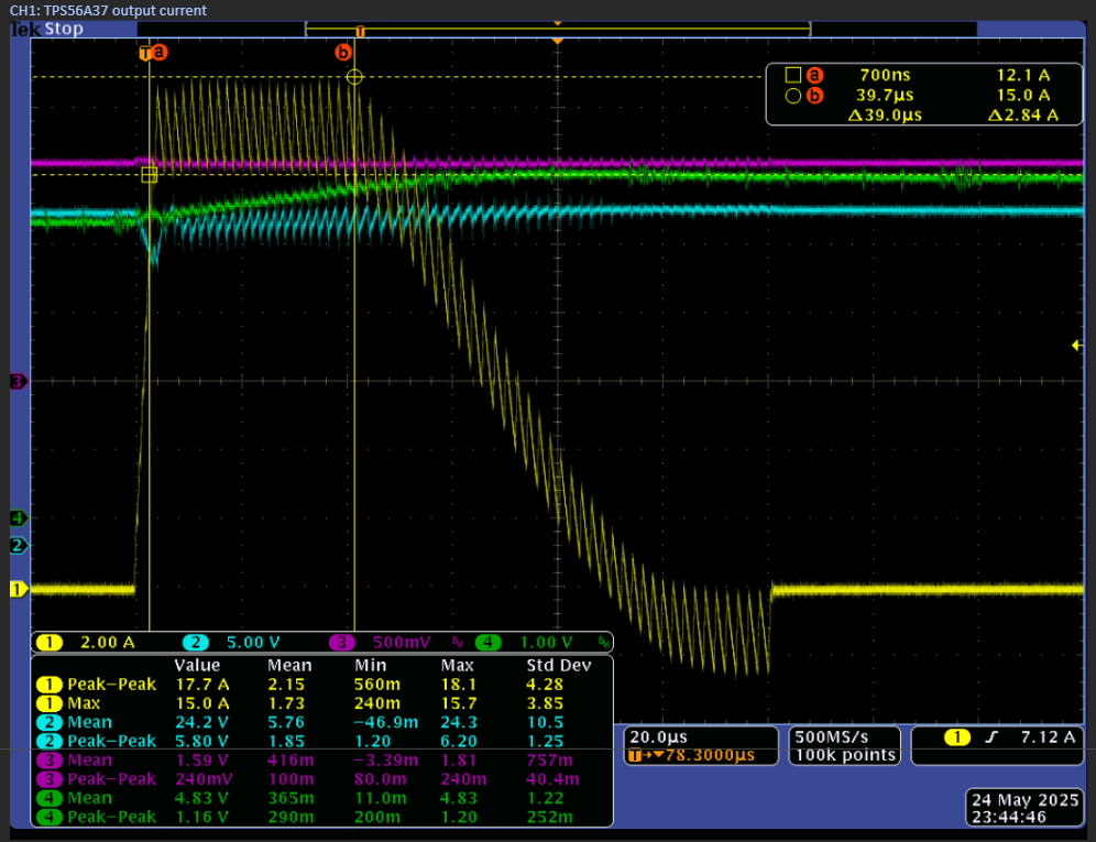

Hi TI team,
We are currently using TPS56A37 in our design.There is a MOSFET that connects the output rail to the downstream system.
When this load-side MOSFET turns on, a significant inrush current occurs at the TPS56A37 output. Based on the waveform measurement, it appears that the inrush current hits the high-side and/or low-side current limit for approximately 40 µs.
We would like to understand:
  1. Is this behavior considered normal protection response of TPS56A37?
  2. Could repeated triggering of current limit for ~40 µs cause long-term reliability concerns or potential damage to the device?
Any guidance would be greatly appreciated.
Tom
