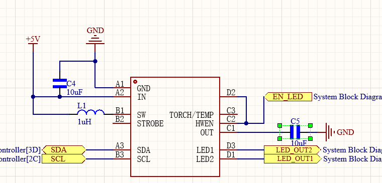

LM3643: LM3643 Triggers OVP (overvoltage protection)
Part Number: LM3643
This is the schematic i used. For IN I attached a power supply with around 3.6v .

I2c is working fine. it triggers the OVP  on FLAGS2 register over and over again. I attached oscilloscope for out pin and i can see its voltage goes for 5V and then cuts off suddenly. for the led I attached a 2k ohm resistor . then attached an LED no voltage on LED pins. How to resolve this?
