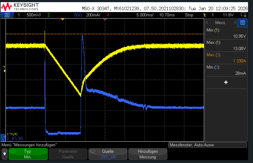

we are facing some malfunction issues with the LM5175PWPR on our PCB. The error occurred more than once after we got our devices back from the customer. We have no clear customer usage statement of what happened. We assume that some kind of overvoltage event happened. The error cases with different customers does not follow a clear pattern.
We use the LM5175 as buck-boost converter for 6V … 58V Input and 12,5V@2,4A output. The design is similar to the dev board. Our PCB layout is relatively bad designed. We made by commissioning bode-analyzer measurements and the regulation is stable and OK. All measured values fulfilled the IC specification by commissioning.HDRV1_Vout.pngregulation.pngVout_Iin.png
Following states were determined by us:
  • When going from high input voltage down to 20V the IC has the malfunction. The output voltage rises to 13,5V and the IC turns off. After around 10ms at 10,9V output the IC turns on again. In all other states the output voltage is stable at 12,5V.
  • In Buck-Boost mode the current consumption rises. Good IC has 7W and bad one 8,9W in our application. In separate Buck and Boost mode the power consumption and voltage is OK
  • On FB, Bias, etc. we see no wrong behavior
  • When connecting a passive probe 11pf-10Mohm to HDRV1 IC pin 27, the regulation works without any problem. In added osci pictures HDRV1 is Q1060 mosfet Ugs. I_KL30 is the input current.
  • Measuring the desolder IC we have 5Mohm between pin 15 and pin16. With a good IC we measure 6Mohm. Don’t know if this is relevant. Didn’t find any resistance values in the datasheet.

  • Hey Stefan,
    yes thats the case with the customer. Our internal µC detects an 12V5 abnormal behaviour and sends an software error. Due to this error we got our devices back from the customer to investigate. The device is still working in all other aspects. High in our case is 20V ... 32VDC and worst-case transients to 58V.
    One difference is the power consumption. The malfunction IC has 8,9W power consumption than a good IC 7W (base load) at 24V input. At other input voltages the consumption varies to.
    The 13,5V controller switch off is correct. We measured the time more precisely, it is 9ms instead of 10ms. In this time the high side input mosfet Ugs=0V.
    One inconsistency in my mind is that the bode-plot shows stability. On the other hand a passive probe on Pin 27 vs 0V results in no more occuring problem. For me this means bad layout and or noise coupling into the IC. Is this a possibility?
