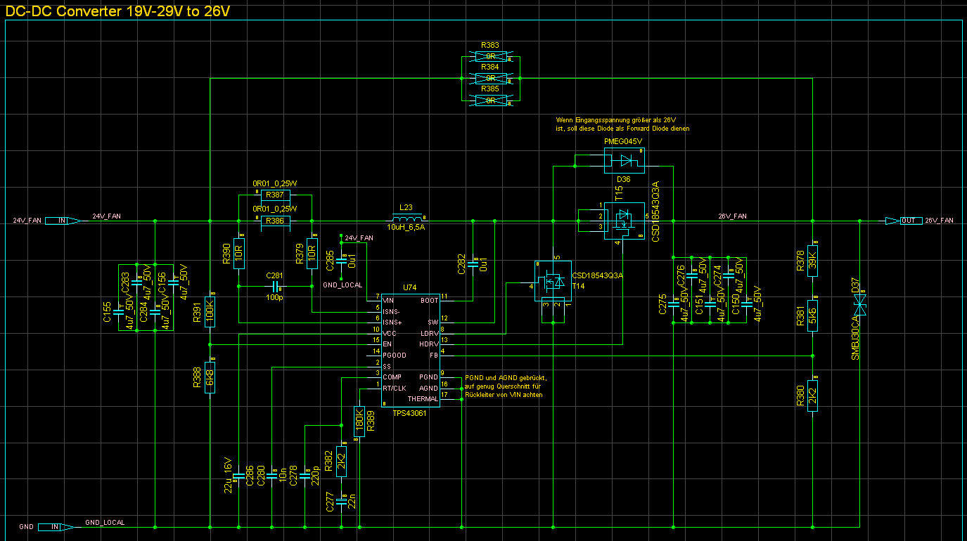

Description of our Use Case
We are using the TPS43061RTER to convert our input voltage ranging from 19 V to 29 V to 26 V output voltage to power fans in our device.
Schematic

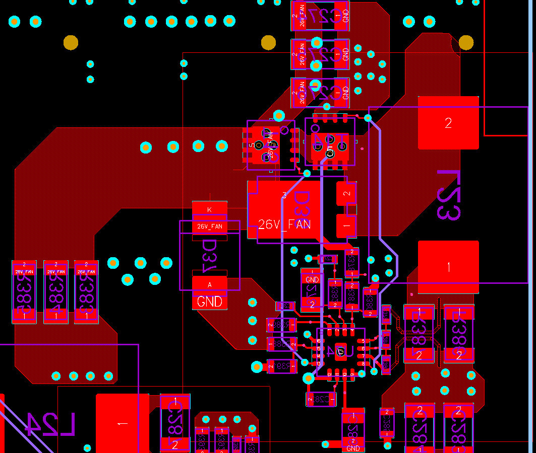

Layout

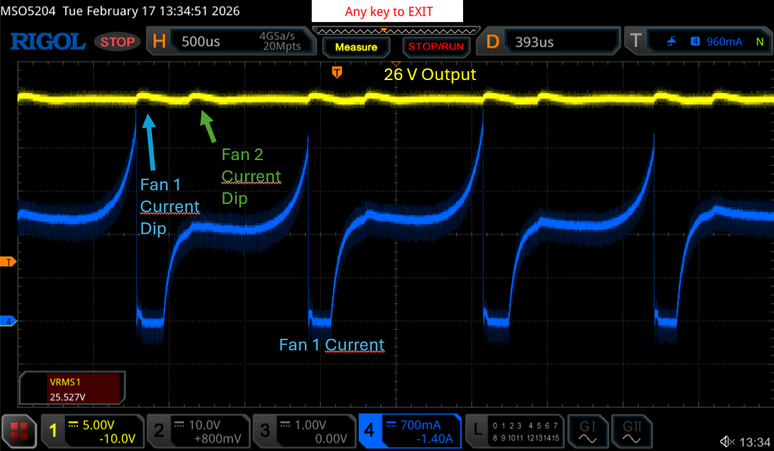

Further Details to the Load (Fans)
We have 2 fans connected in parallel with the following ratings on the 26 V output:
  • Rated voltage: 24 V (26 V is acceptable per manufacturer specifications)
  • Rated current: 1.5 A each (3 A total)
 The oscilloscope capture below shows the fan current draw from the 26 V rail and the corresponding output voltage behavior.

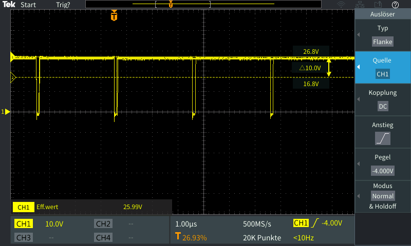

What we measured so far
SW-Pin
The following measurements capture the SW pin behavior immediately before failure. We do not observe anything obviously abnormal.

    However, there is still a risk of negative undershoots. Here, the SW limit is give as -0.6V general and -2V for 10ns transients.
    You have already shared a SW waveform measurement, but would it be possible to run another test and zoom in on the timescale to clearly see the undershoot length and amlitude?
    In the waveform, it looks like there is some undershoot and oscillation at the moment the low side MOSFET turns on. (approx. -4V undershoot?)
    You can also run this measurement with the resistive load to avoid damaging further ICs. This would also give a direct comparison on whether the undershoots change with a different load setup.

    The TPS43061 device does not have a "bypass mode", where it turns on the high side MOSFET 100% for VIN > VOUT. This means the MOSFET can quickly break if there is a load due to overstress on the body diode. For prevention of this, your design already has an additional diode in parallel to share the current, which is good.

    Real life measurement
    We repeated the SW pin measurement with a resistive load (Vin = 24 V). For this measurement, we used the best probe available to us and minimized the probe loop area as much as possible. We measured directly at the SW pin of the chip. Despite these precautions, I suspect the measured undershoot may appear somewhat larger than the actual value due to remaining probe-induced artifacts. If the undershoot were truly this severe, I would expect the IC to already sustain damage under these conditions.

    1. There are a lot of factors that influence the switch node ringing. MOSFET selection, layout, gate driver strength, gate resistance, snubber placement, etc.
    Often the main root cause cannot be pinned down easily and optimization via trial & error with snubbers is necessary to achieve acceptable performance.
    For a new revision, I would recommend to already place footprints for gate resistors and RC snubbers to give more options in ringing prevention.
