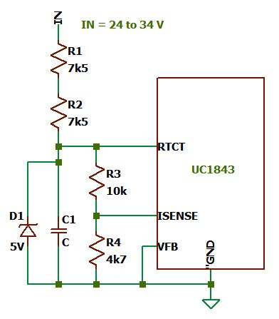

I am working on the design of a step-down DC-DC converter which feedback loop I want to implement externally. This loop works best with a modulator using an artificial ramp (i.e. not derived from an inductor current) with its slope proportional to the input voltage. I had drafted this:

I do not understand why all this circuitry (instead of a resistor divider) given that on the block diagram the pin ISENSE is depicted as an input (presumably high impedance). I have concerns that I am overlooking something and my draft will not work.

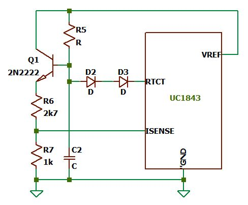

Additionally, I am unsure that the circuit on the datasheet works well in the low duty cycle region (which I need to use because I have low output voltage) because, to me, the 2N2222 B-E voltage drop would result in a low voltage at the ISENSE pin for a short while after the timing cap C_CT is reset. The way I see it, in order to have a correct slope right after resetting the capacitor, you would need to raise the capacitor minimum voltage:

  • Hi Alejandro,
    The circuit shown below,
    provides a constant current source for C_CT. This makes it so that the the RT/CT pin has an idealized sawtooth ramp, as opposed to a non-linear RC-dependent ramp. This provides better control of the duty cycle in voltage-mode control.
    The other circuit shown below,
    simply takes a stepped-down copy of the RT/CT voltage, without altering the impedance seen at the RT/CT pin.  If a simple voltage divider was used here, then the frequency set by the combination of the R and C would be altered. This circuit is needed to prevent altering the impedance at the RT/CT pin.
    Let me know if this makes sense.
    John
  • Hi, John, thank you for your response, it is insightful, useful and appreciated.
    I now understand the circuits well. However, I am still confused about what I described by the end of my previous post (last diagram, low duty cycles vs. slope seen by the ISENSE pin when the timing cap has low voltage). Your informed opinion would be very helpful because I am considering adding this 2N2222 but my circuit will need to operate in the low duty cycle region so the modulator ramp (as seen by the ISENSE pin) needs to be correct there.

  • Hi, John.
    Thank you for the thorough response. It is well understood, very useful and much appreciated.
    What I was missing is that that RT/CT pin discharges the timing cap to 1.1 V not to zero. That way the 2N2222 can "copy" a correct ramp despite its B-E voltage drop.
    I have been looking for this minimum value on the datasheet but only the peak-to-peak of 1.7 V is given (useful as it relates to the overall modulator gain dD/dV_COMP, together with the 1/3 divider).
    The two diodes I added to the design on the datasheet, shown on my sketch, were an attempt to introduce this offset.
    I understand that the error voltage can travel across the whole modulator ramp range correctly (but thanks for stressing it), but I was concerned that the ramp reaching the modulator "PWM comparator" would have an incorrect slope in its lower region.
    Best.
