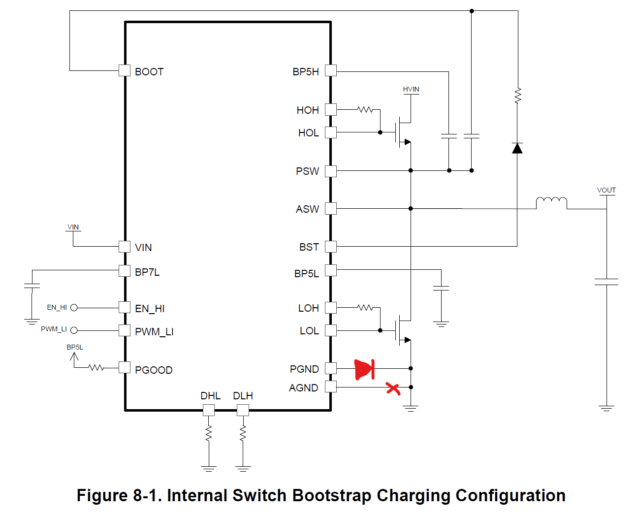

We're using the TPS7H6013 to driver a BLDC motor. We want to isolate Pgnd and Agnd but in the pin description, it mentions that they are connected internally. Would it be viable to add a schottky diode to prevent current from power ground to go through analog ground? Are there any drawbacks from doing this? The FET we're using needs to be under 0.8V to turn off fully, so the LOL pin would have to be under that voltage.
