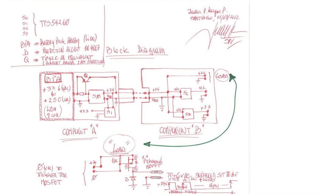

     I do have some concerns regarding transients and wonder if you may have some comments regarding the following:
    1.- I designed a device with a LiOn battery pack array "BPA" (8 cells in series for a 33.6 to 28.5 V delivery)
    2.- Al initial tests have been made using linear regulators
    3.- The BPA feeds three different power sources: +24VDC; +12 VDC and +3.3 VDC
    4.- The +24 VDC is the supply for a +6VDC Solenoid, settled to work according to a 6% Duty Cycle. The solenoid is activated by a driven P channel MOSFET. The Mosfet will drive two +24VDC/ 350 ms pulses, separated by a 300 ms 0V time gap, within a 17 seconds repetition frequency.

  • You might start with posting a block diagram.  That may be easier for us to follow than a text description.
  • Hi Jack, Thanks again for your support and sorry for any inconvenience with previous replies on my behalf.
    I have improved my design after several iterations with the switcher pro application and have decided to use TPS 54260 for all regulators shown, i.e. S0; S1; S2; S3. FInally,  I have decided to proceed as shown on the Block Diagram; however I still have a remaining question, regarding athe use of a Bipolar Transistor within the design:
    Question.- Is it possible to consider a current enhancer through the bipolar transistor "Q" shown on the diagram. I am inclkuding it to be sure the current through the load (SOLENOID) is assured. Even though the load will draw 1.8A during  two 350 ms trigger pulses separeted by a time lag of 300 ms, I would like to have a 3 Amp to 4 Amp protection. Please advice.
    Best regards, JP
  • First off let me say I am a little uncomfortable with VIn min = 25 V and Vout = 24 V.  That will have the TPS5426o running near 100 % duty cycle.  Under certain conditions that device can lose enough BOOT charge to trip the BOOT UVLO circuit.  The device wil still operate but you may see 2.1 V ripple on the 24 V output.
    I do not think that the Q1 is a good idea.  If you need higher peak current, then I think a controller with external FET would be better to generate the 24 V intermediate bus voltage.

    You are right with the Vin Min, which I readjusted to be +26VDC but realized I had not corrected on the sketch I already sent to you. Regarding the simultor, when data is entered to it with Vin Min +25VDC it fails, but using Vin Min +26 it solves the problem. I'm a little worried with the Peak current for the +24 VDC regulator. This power sorce must be allocated within Device N1 of the drawing, so any current enhancement must be kept within component 1, that by the way is physically separated of component 2.
    Will do the homework on the FET approach you suggested. If any doubt on my behalf, may I contact you again ?
