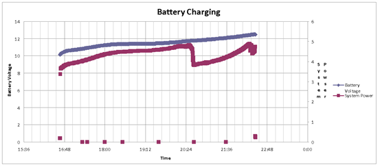

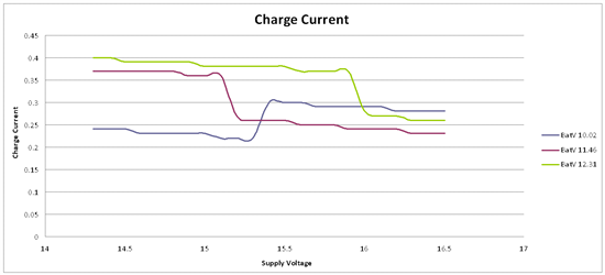

    Followig the recommendation in the data sheet.  There is a sense resistor that comes off BTST called Rsr.  The current is monitored by the charger via SRP & SNP but we also monitor this same sense resistor via the micro and display the value near real-time and log the value during the charge cylce.
    I have attached two graphs.  One showing a change in supply voltage and the other with a constant supply voltage.  The battery charge current is set to 400 mA.  Note on the first graph that for a charged battery (12.31 v) the charge current starts good at 400 mA but takes a big dump around 16 volts.  Also note that with a discharged battery (10.02 v), the chage current starts at around 240 mA and takes a big jump around the 15.4 v mark but never exceeds 300 mA.  Why, I'm not sure.
  • Looks like my first graph didn't post.  Reposting.

  • Some more info concerning the first graph tittled "Battery Charging".  Note the large decrease in system power (actually charge current) near the 20:24 mark.
    Supply Voltage = 14.1
    High Charge Current =  (5W/14.1V) = 354 mA, Low Charge Current (3.7W/14.1V) = 262 mA.
