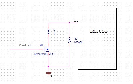

As we know, we can connect different value resistor to control the charge current.
In my project, I want to set two situation, my mean is use two vaule in two case. How to implement it?
Can I implement it as the picture? When Vcontrol is low, Rset is R2. When Vcontrol is High. Rset is R1//R2.
