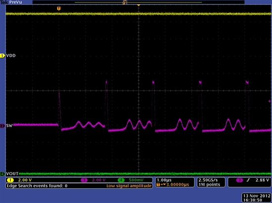

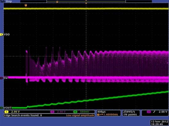

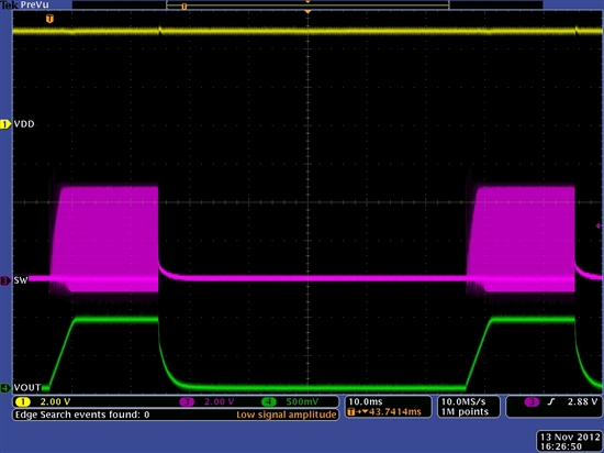

  • Hi Na,
    I tried two different resistor values in the BOOT path, 3.3 and 1.1 ohms. In both instances the performance of the circuit degraded. Basically the 0.9V output never turned on with a 5.0V VDD.
    The high-side capacitors are located directly beneath the FET on the opposite side of the board. We have multiple HDI and CORE vias per capacitor. The VDD net is a plane. We have multiple GND planes in our stackup.
    I tried a snubber circuit between SW and GND. I used a 1000pF capacitor with both 2.2ohm and 1.1ohm. There was no noticeable performance with either RC combination. The circuit was placed very close to the SW pin.
    Below are a few scope traces. I believe the moment when the output voltage turns off is approximately the time when our digital logic tries to initialize. It would seem we are on the correct track but nothing I'm doing on this end seems to improve the behavior (other than increase the operating voltage, which is not an option in our final design).
    Aaron
  • Hi Aaron,
    Can you isolate the digital logic for debugging purpose?
    Na
