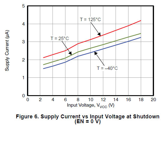

I would like to ask a question concerning the TPS24701.
The datasheet lists two different values of supply current when Ven = 0V.
One is given in the electrical characteristics table:
Supply Current: Ven = 0V, Iout + Ivcc + Isense:               0.45mA Typ
the other values are shown on Figure 6 which are in uAmps range:
I've tested the part and my reading is 0.446mA @ Vcc=12V, Ven=0V.
Could you please explain if it is possible to achieve the uA current consumption (as on fig.6)
Thank you
