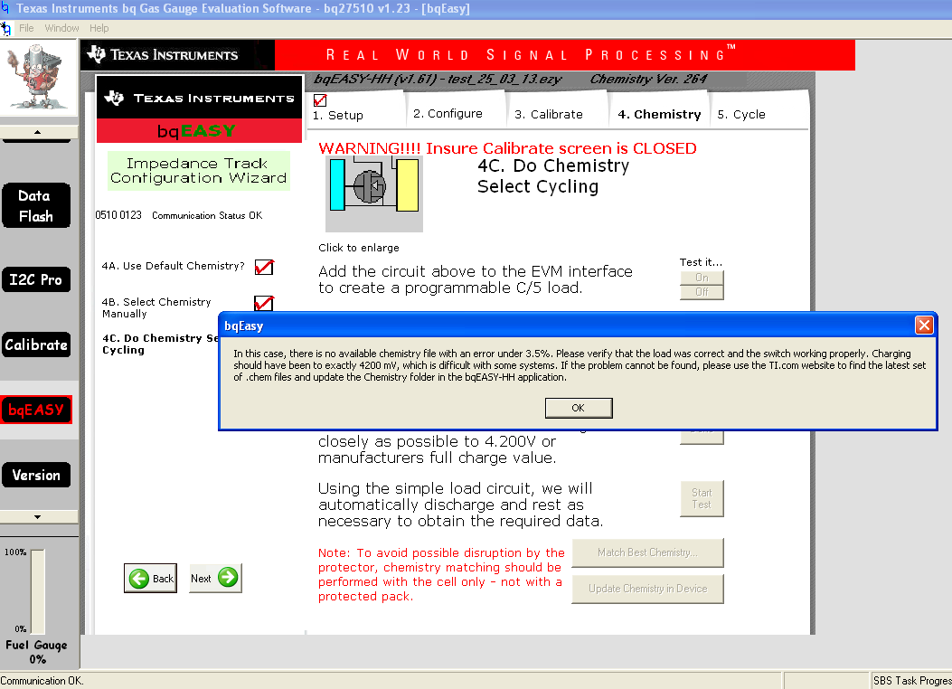

I am trying to learn the chemistry of 2.4Ah Ultralife battery (P/N:UBBL19-C1).Since this battery doen't come under the   list provided by the Ti ,I did the chemistry learning cycle.
 After 1 day of learning process it  shows the following error messages
I can share  the log file of the battery chemistry learning cycle if required.
Kindly guide us since our production is in halt.
