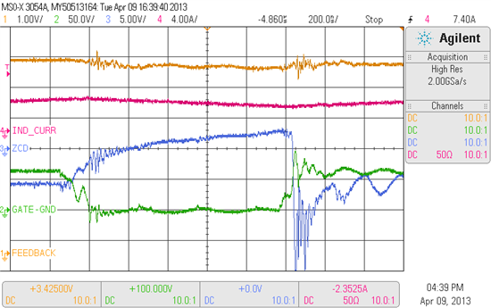

I'm working on a 10 KW 2-phase BCM buck converter based on the UCC2806x but got stuck. I've 'folded' the math and ins/outs so it works for buck application, and the circuit is working quite happily for a range of in- and outputvoltages. For any other range, strange things happen. This range is not clearly defined, but lies in the range of Vin=2xVout. Above and below is no problem (30KHz switching freq. works just as nice as 120KHz)

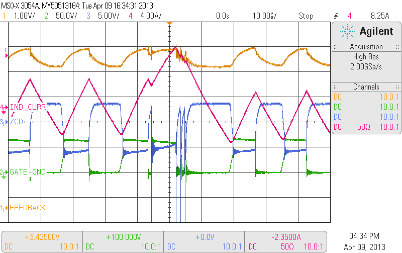

What happens is that immediatly after the gate driver (IRS21850 single high side) is turned off and current starts falling, the controller turns the gate on again, thus ramping current further up until it hits the current limit of the lab supply used. Most of the time the gate drivers don't survive. The same thing happens when GDB is disabled, when VINAC, VSENSE and HVSEN are externally controlled and when seperating  or not seperating PGND and AGND.
I've looked at it with a few colleagues, redesigned grounding and signal routing and ruled "everything" external out. The feedback may not look stable, but this is pickup. Gate B is completely disabled and remains so, even when A decides to turn on. When connecting gate B to Comp, the controller works fine until A starts misbehaving and then chaos happens, as can be expected. So, for tests, i've disabled B.
Green = Gate of MOSFET A vs GND (so a bit dirty, sorry for that, we've not kept every screenshot)
Blue = ZCD winding of A vs GND before RZCD
Purple = IL,A

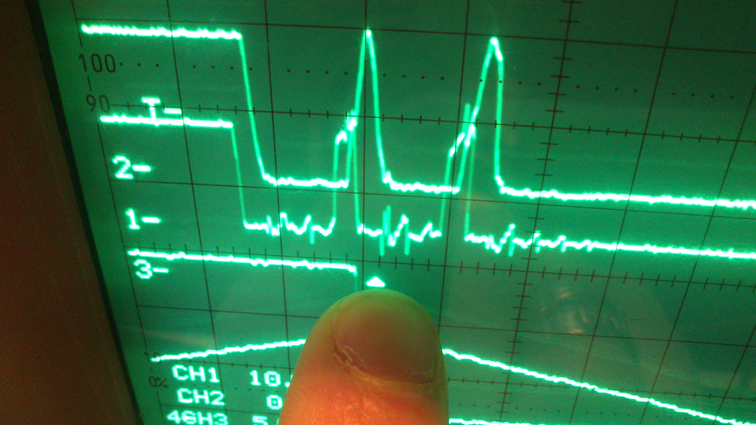

Then we have (different scope, different day)
Top: VGS (diff probe) MOSFET
Bottom : output of Controller GDA
Clearly, the controller is first to turn on again. Not the FET, not the Driver, not the Current Sense winding, but the Controller itself. I've got more scope shots of all the other signals to reaffirm this statement.
I could list everything i've done, but in the beginning there was almost no decoupling and/or limiting switching speed and long wires. Now everything is limited, filtered and built on the controller itself. I've used other power supplies, coax or twisted wire. I've also eliminated reflections and ground bounce from controller to gate driver. All signals, supplies and ground became cleaner and cleaner, but no difference in behaviour.
Why does the controller decide to switch on again, with no apparent external cause?

  • Hello Floris,
    Look for noise or interference coupling into one or both of the ZCD inputs.  A noise "glitch" on these inputs can prematurely turn ON a gate-drive that normally should be off.
    In an ideal environment, the ZCD inputs work like this:
    When the on-time for GDA, for example, is completed and the Phase MOSFET is shut off, the current inthe inductor demagnetized and the ZCDA voltage swings positive during this demagnetization time.  When ZCDA rises above the 1.7-V threshold, it "arms" that phase to turn on again once the zero-current detection (ZCD) crossing happens.  This crossing is defined as when the ZCDA signal swings back negative and falls below the 1-V turn-on threshold.
    The ZCDx signals are usually derived from sense windings on their respective inductors (often relatively remotely located from the controller).  In the real world, the windings or the signal-track loop can pick up switching noise either from the other phase or from some other nearby power circuit.  If this noise is large enough, it can drive the ZCD signal below 1 V and turn that phase on before it should.  I think this is what appears to be happening in your system.  Phase-B's turn-on switching couples negative-going noise into ZCDA and triggers GDA to turn on again before its inductor has demagnetized.  This problem can exist for either Phase A or Phase B or both at the same time.  Careful signal routing is necessary to prevent this, including running the GND return for each ZCD winding back to the IC on a separate closely-spaced track parallel to the signal track.  Avoid connecting the ZCD-winding GND directly into a convenient nearby high current return path, which are often near the inductors and some distance from the quiet IC GND.
    The ZCD inputs use current-limiting resistors in series with the windings, and a small capacitance to adjust the ZCD timing.  Avoid increasing these cap values for better "noise filtering".  They are not filters, but are intended to precisely set the turn-on timing to implement BCM (or as TI calls it: Transition Mode - TM).
