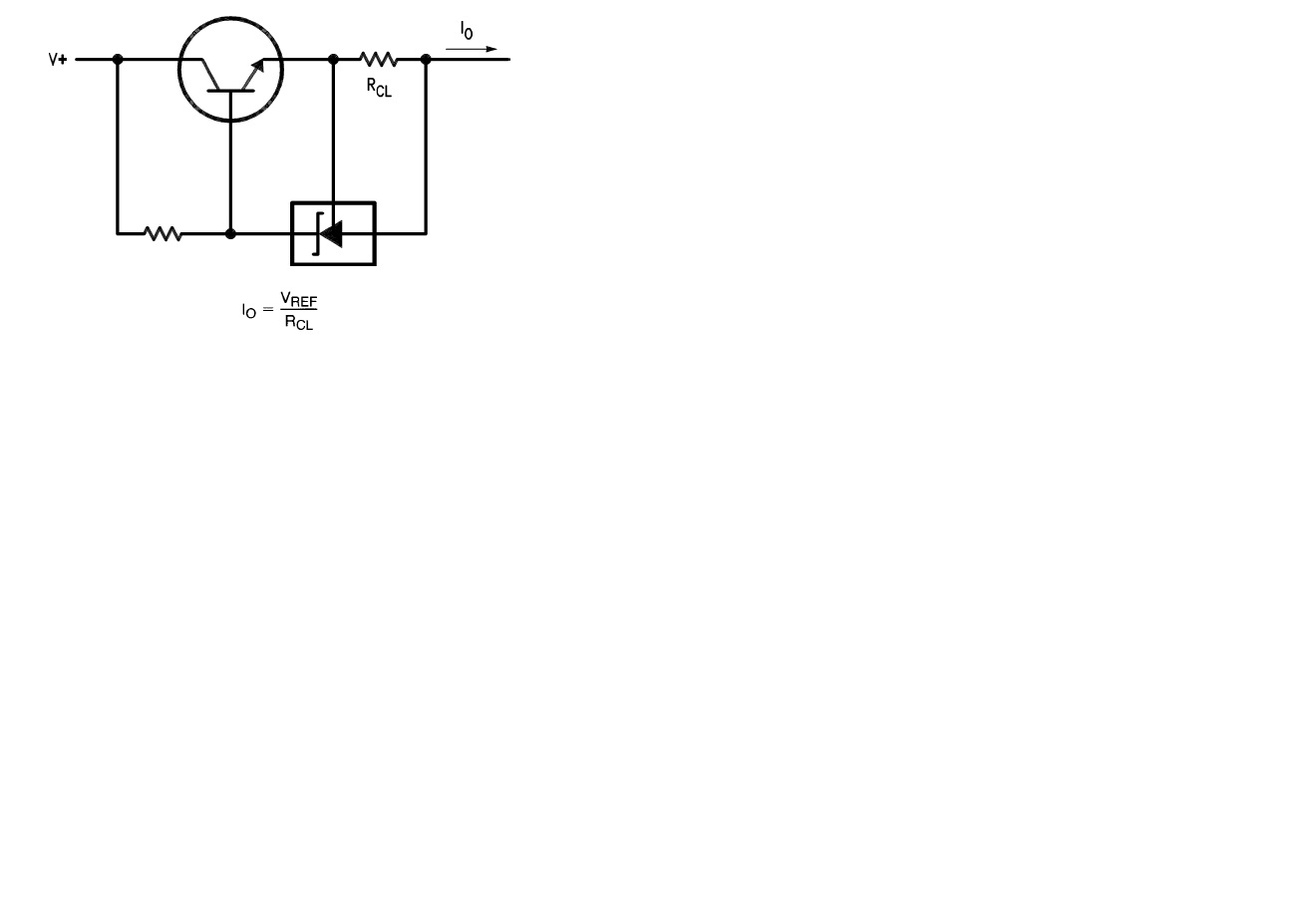

  • John,
    I have recently used the attached circuit using a TLVH431 (at 2mA) and found that the turn on time was less than 1us.
    It should work also well at higher current.
