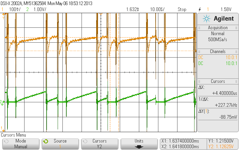

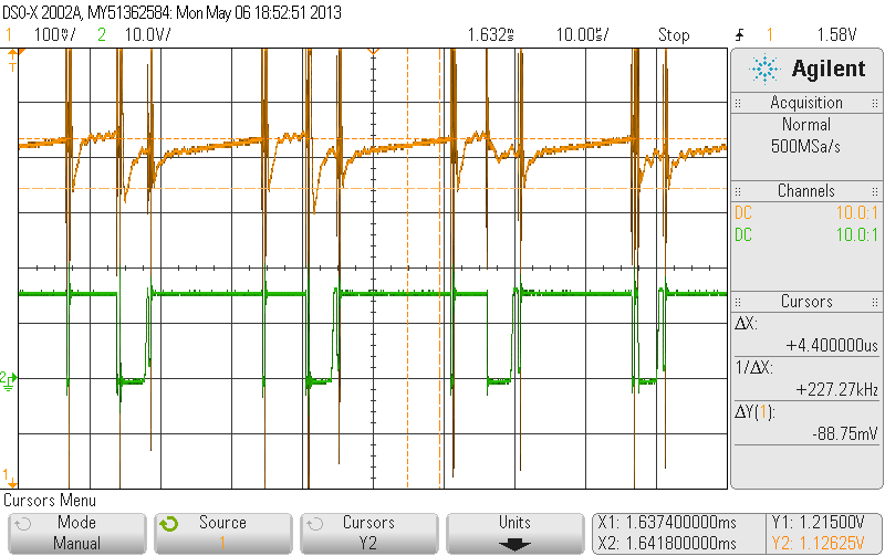

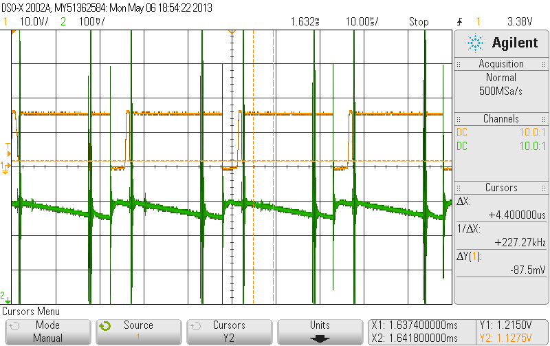

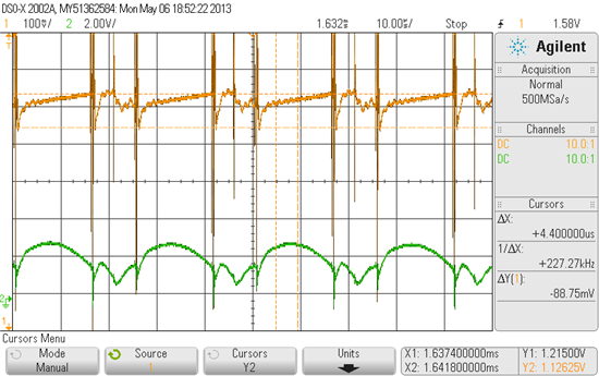

i am trying to build MPPT solar regulator with Lm5088 (input solar panel with Vpp~18V and output is 12V acumulator). I've tested Lm5088 alone, and it worked properly. Next i've modify feedback, with Lm431 reference and AP358 op-amp. When i am changing R4, it regulates input voltage, but it doenst work at desired 220kHz. Input voltage oscillates at frequency 5-10 times lower with Vpp~100mV. Ï thought, thats is a problem of compensation. I've disconnected compensation network and feedback from output voltage and measure signals at FB, COMP, VIN, SW and RAMP. without compensation network i've expected low respective high voltage at COMP pin when FB voltage is higher respective lower then internal 1.205V reference, with fast transients between these two states. But i've measured slow transients like at image 0. Is there some internal compensation ? Or i am missing something ?
Does anybody knows some coockbook to make correct compensation ?
There are schematics and measured signals:
image 0: yellow FB pin, green COMP pin
image 1: SW pin green, FB pin yellow
image 2: RAMP pin green
image 4: Vin (solar panel) green, SW pin yellow
Michal

    Since LM5088 switching depends on COMP pin voltage, if your COMP pin is floating like as your schematic. Nothing will work properly.
    Please try controlling FB with the compenstion network or contol COMP pin directly using your own compensation network.
