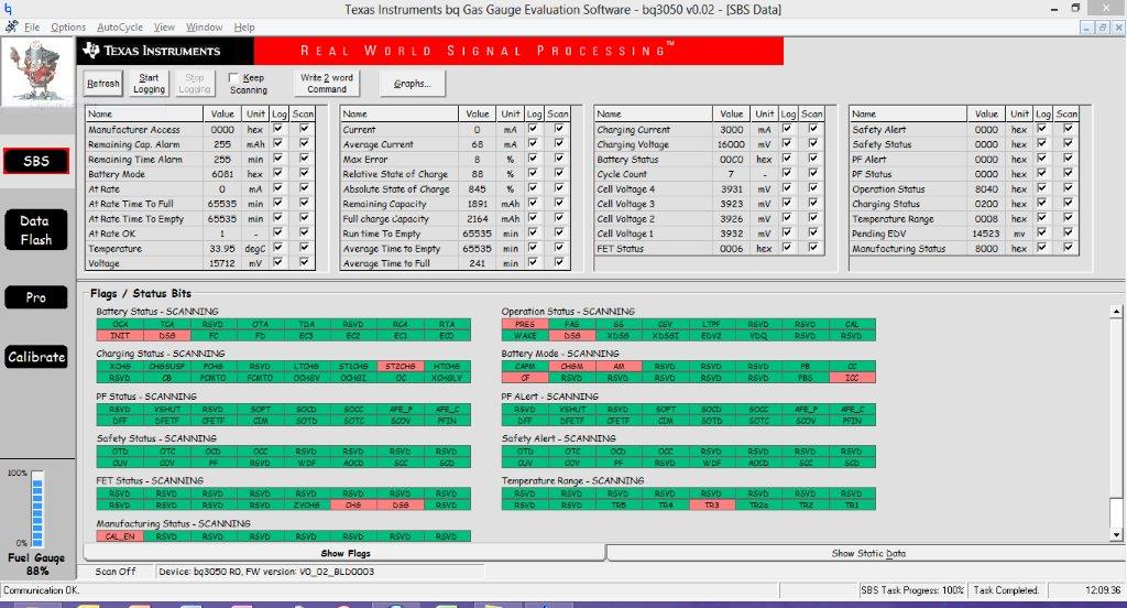

    We use a BQ3050 as a gas gauge for one of our project and we have made some awkward observations concerning some read only registers in the gauge.
    For example, the absolute state of charge register is set to 100% after calibration. After complete charge and discharge cycles, the register value is updated. During the charging part of a cycle, the value is increased from 70% to more than 100% (see screenshot in attachment) and then decreased during the discharge part of the cycle to 70%.
    In the other hand, for some new gauge, after the calibration process, the remaining capacity, relative state of charge and absolute state of charge registers are set to 0 whereas the cell voltage is around 4V. After complete discharge and charge, the registers are not updated and we don't know how to reset them to the default value to re-iterate the calibration process and use these packs.
    Do you already have seen such a behavior and how is it possible to completely reset the flash of the BQ3050.
  • Christophe,
    ASOC is based on the Remaining Capacity and Design Capacity or Design Energy. If it is set to 845%, or reporting erractically, then the Design Capacity or Design Energy must be set incorrectly in the data flash. Are you using CEDV Coefficients to calculate the EDV thresholds or did you set the thresholds yourself? There is a Mathcad program to help set the CEDV Coefficients, if you are using that technique. You can export a gg file and attach it and I can review it for setup errors.
    Tom
