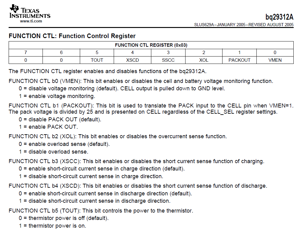

I 'm using  bq2084+bq29312a chipset. But I don't want to use DISCHARGE OVER LOAD function of bq29312a. Is it possible to turn off with bq29312a?

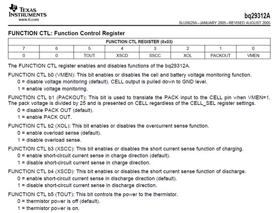

The below data is about 29312a. I believe OV function off if 'XOL' bit is changed from low to high. Unfortunately, I can't find to change this bit.
please advise to me.
thanks.
  • Kim,
    The device does not offer the option to disable the AFE over current features. You can set the detection threshold and time to their maximum values to make it unlikely that a fault will be triggered.
