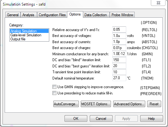

    i ran your schematic with Orcad Capture 16.6. i was able to finish the simulation. i used the following options. please let us know if we can assist you anything.
  • Hi Touhidur,
    Thank you for your expedient reply!
    Increasing RELTOL seemed to fix the issue, also in capture version 16.3.
    Once again thanks for your help and I look forward to playing more with your model :)
