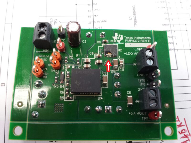

    But we have a problem: substituting resistors should be easy, but suddenly i realized that modifying U2 pin configuration is a pretty hard job, is it possible to realize this on delivered sample? or it must need to redesign a new PCB to have ±12Vdc?
    Is it possible to have Protel or Altium Designer Project of this EVM ?
    MR
  • Hi, I'm wondering also if it is possible to buy somewhere directly this module designed to deliver ±12Vdc output, is it available to purchase?
  • I looked at the PCB files.  To get that 12 V output you will have to cut some etch or lift pins and "blue wire" the correct pins to GND.  It looks like there is only one version of that board and it is wired for +/- 5 V as you observe.  The files are in PADS format.  Can you use those?

  • It looks like that is a 6 layer board.
    I think you can just power the EVM from the 12.4 V and connect it to your load instead of the LDO on the PMP8372.  If you are worried about the power consumption, then you might want to remove U2 and its associated external components.  But I think the easiest rout is to modify the existing PCB to make U2 provide 12 V.
    You will get quite a bit more ripple and noise if you use just a switching regulator.  You application may well work with that, but you will have to test to be sure.
    I tried to contact the designer of that reference design, but there is no valid email for him.  He may no longer be with the company.  I'll see if i can find someone from that producr line who supports this.
  • Hello John,
    i have tried to remove U2 to modify pins connection but it was pratically impossible to desolder with hot air and an experienced technician, also passive components don't go away..
    Finally ldo get damaged.. so we're waiting for modified gerber files... The problem is that it is also a 6layers PCB...so it is very expensive to produce and cost for every PCB will easily be more than 250€ ... The PMP is a very small circuit so if there is available also the same circuit with a 2 layer PCB would be perfect..
    Please let me know.
    MR
