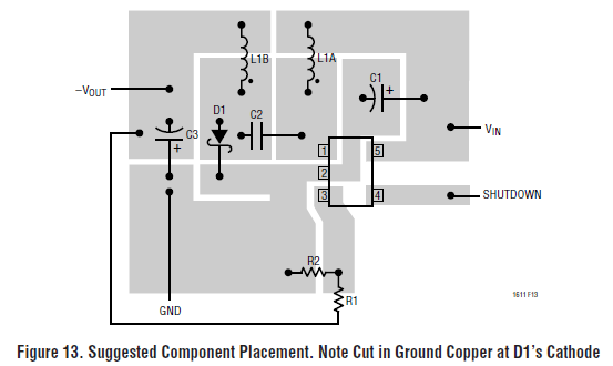

Are there any layout guidelines for the LM2611 (for the standard components in Fig 21 of the datasheet SNOS965I)?
I'm looking for something like the one given in the LT1611 on p.8 of http://cds.linear.com/docs/en/datasheet/1611f.pdf
