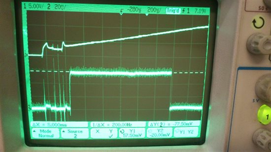

  • From the look of your waveforms, I think you are triggering hiccup mode OCP.  I would look at your calibration voltages during start up. Also it seems you have some dc offset on the ENSS pin.  It needs to go below 270 mV to ensure a restart.
  • What is the reason for the OCP triggering with such a small load (120 mA) and with this type of MOSFET (about 9 miliohm)?  Which calibration voltages do you mean? On ENSS pin, there can be seen the calibration after power on at 1,3 V for about 2 ms. The DC voltage is due to the short time of power off, when I measured the waveforms on the pins after startup. Is there a need for the ENSS pin voltage to go below 270 mV to ensure a restart even if the input voltage goes to the zero (manuall shorting of the input capacitor after power off)?

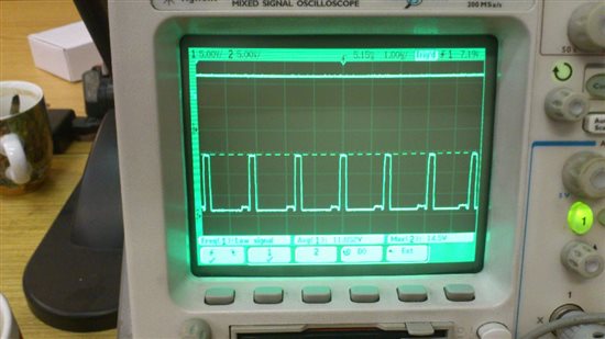

  • I made a couple fo measurements focused on the OCP mode triggering.
    The startup OCP level calibration seems right, OCP voltage level is about 57 mV (5k6 resistor)
    Waveforms on SW pin 8:
    The whole group of pulses
    The detail of the low MOSFET switching, voltage drop is about a few mV, so in the limit
    Detail of the last 6 pulses in the group of pulses - the higher voltage level maximum drop is about 750 mV, it seem that the HDRV driver cannont full open the higher MOSFET at the end

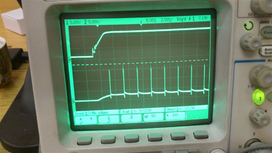

    Waveforms on HDRV pin 7:
    It confirms the previous waveform from SW pin, for some unknow reason the voltage on HDRV gradually falls from 14,4 V to the minimum od 12,9 V before the controller stops the switching
    The detailed upper part - the maximums of pulses, there is a voltage drop of about 1,3 V at the end
    The detail of the last 6 pulses - there can be seen the slowing down of the rising edge
    HDRV voltage relative to the input voltage - upper MOSFET drain, HDRV is gradually falling, driver cannot open the MOSFET

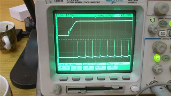

    The SW voltage compared to the input voltage
    Comparing the BOOT to SW voltage - when the upper MOSFET is ON, both voltages are the same
    Has someone the idea why the high MOSFET drivers gradually fails to switch?
