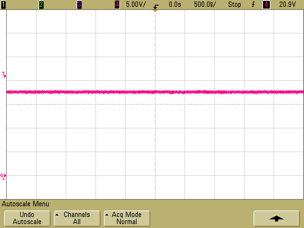

Hello everybody,

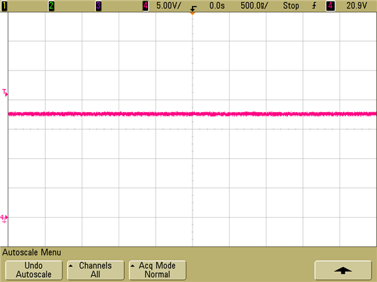

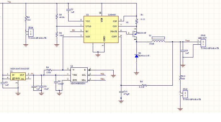

I have designed a PCB board to drive 12 leds, 6 pus other 6 in parallel conection.
The requirements for this design are 24V input, and adjustable current from 0 to 1.6A via Iadjust analog pin.

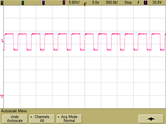

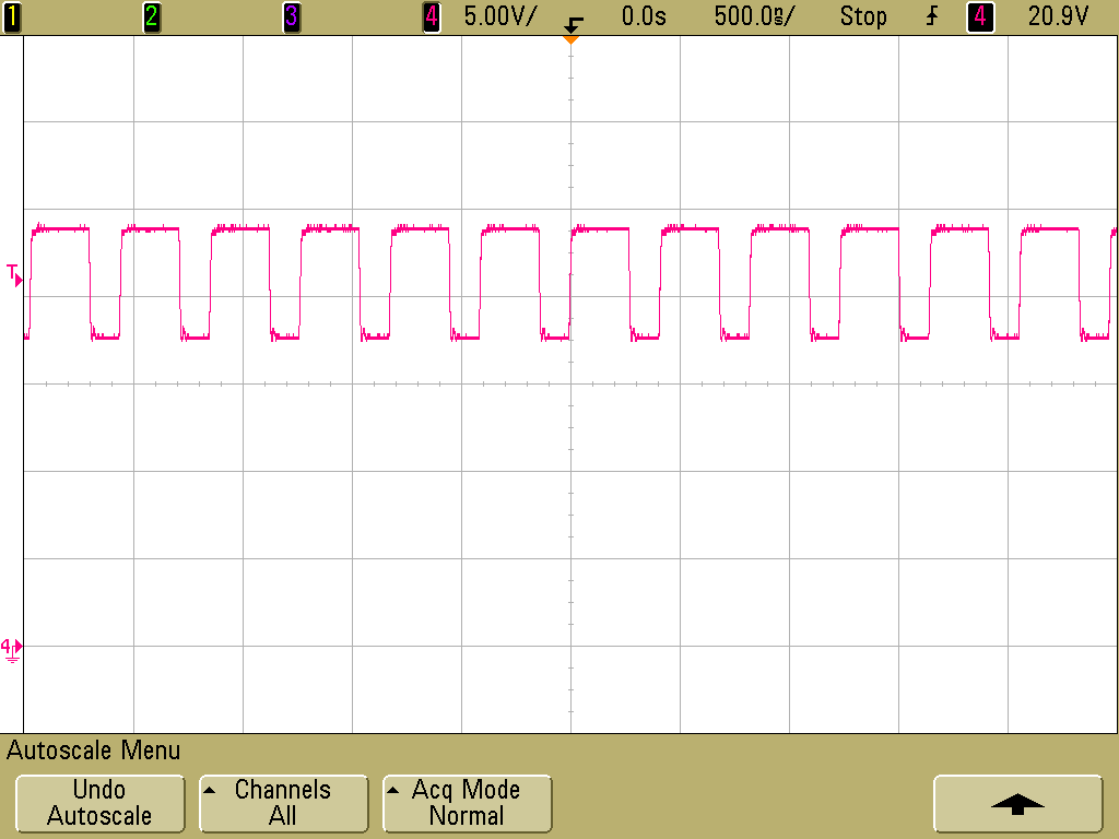

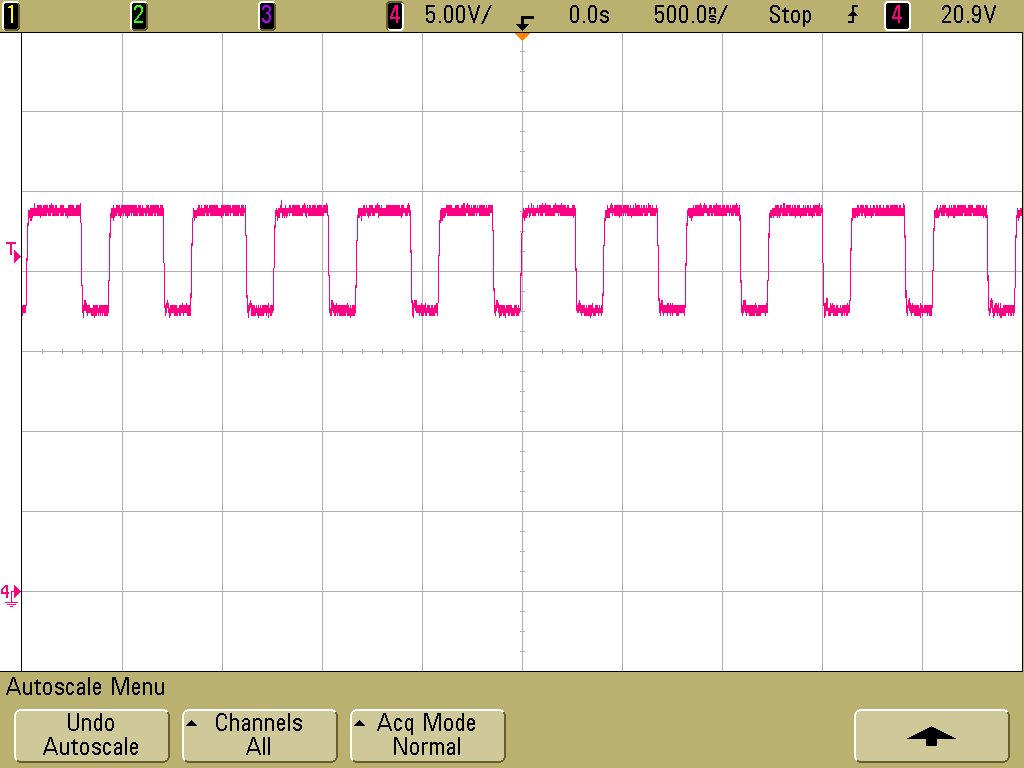

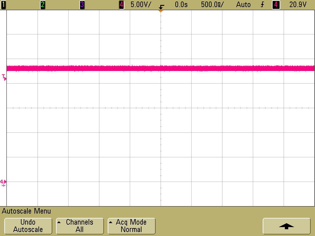

The circuit dont work, the leds have the same voltage that Vinput. PGATE works, but with a signal independent of the voltage of the Iadjust pin.
When I turn Enable pin to 0V, the circuit blocks the current.
The circuit is the next:
And the LEDS are SMB760-1100-05-I model from USHIO. Datasheet attached:
6874.SMB760-1100-05-I.pdf
