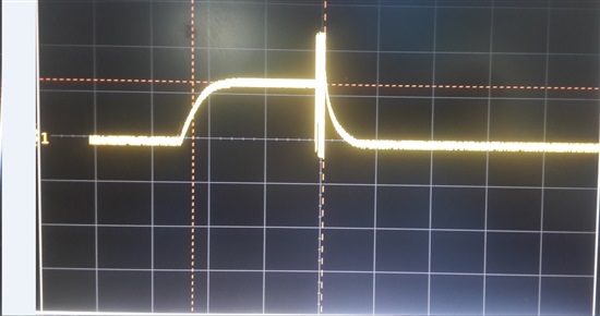

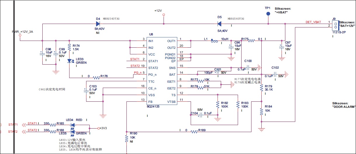

      I found when the battery does not connect, LED4 on STAT1 pin was flickering at the same frequency of battery detection. At this time, the waveform on OUT pin is as below shows.
      I have attached the schematic. I can't understand why the LED flickers and how to solve the issue. Thanks!
