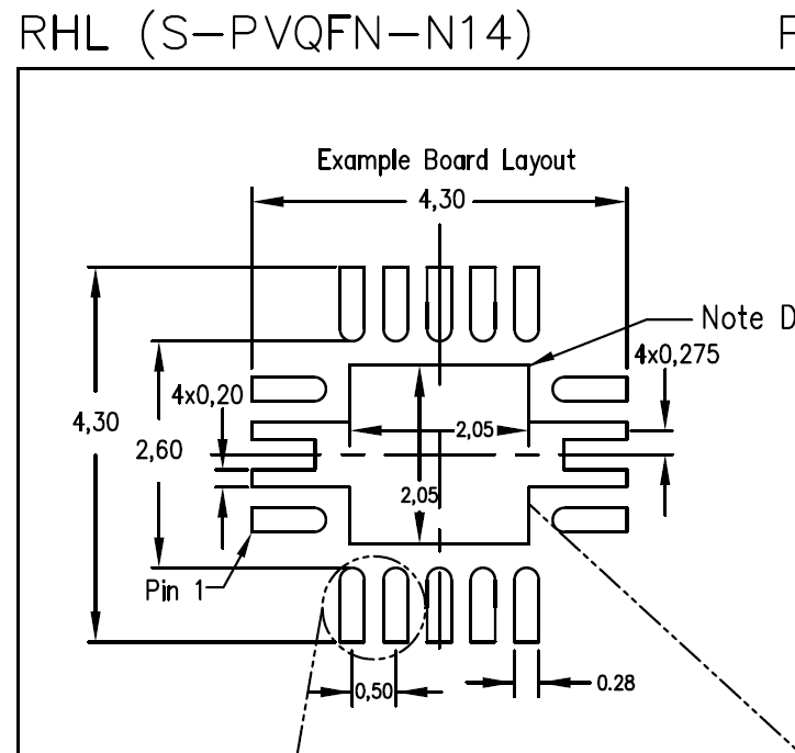

RHL package pins 1, 7, 8 and 14 location
Other Parts Discussed in Thread: TPS54521
Hi - Using the TPS54521 in a rush job, and I can't find a ny specification for the pins on top and bottom. From the drawing they appear to be different pitch than others. There is no explicit call out for these dimensions I could find in any datasheet, app note, or on this forum.
