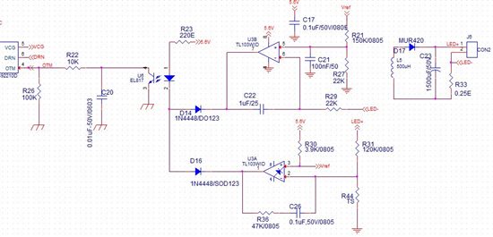

CV using TPS92210
Hi
My 50W LED driver is working fine except under noload condition. When powered ON under noload condition, the controller latches off and requires recycling of input power. To get rid of this problem, I have added a TL103WID hoping it does both CC and CV. But, unfortunately only CC works... Any suggestions to achieve CV?
