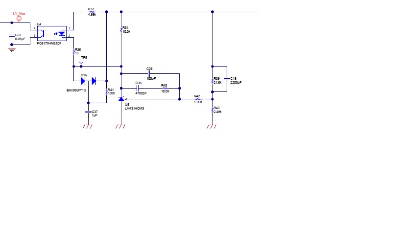

    Please clarify the below queries related to our design requirement:
    1. Is it ok to use the same feedback circuit for the 24.5V @ 17A requirement or do we need to modify it. please suggest design calculation details if needed?

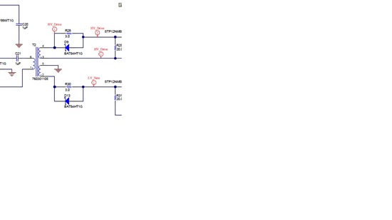

    1. Is it ok to use the same T2 trasformer or do we need any calculations for the transformer driving primary side MOSFETs?

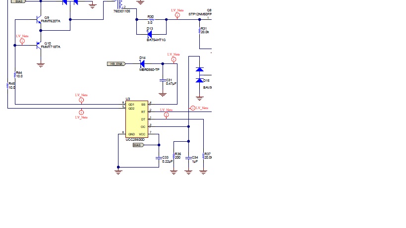

    1. Please let us know other circuitry related to controller UCC25600 in Page 2 of pmp5141 design? Do we need to tune this circuitry for our requirement?

  • Hi Pench,
    1) Without full details of your requirement it is difficult to say what changes should be made to the feedback circuit. It is worth trying the values given, and scaling the LLC output capacitance up with your increased output power.
    2) The GD transformer should be OK provided you do not make a significant change to the LLC operating frequency.
    3) Assuming you do not wish to change the LLC operating frequency, I think you will only need to change the components in the Current Protection (OC pin) circuit to reflect your higher output power.
