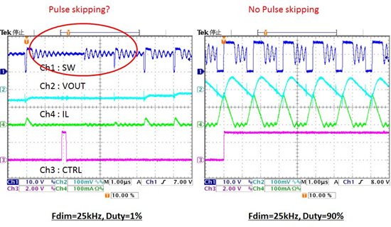

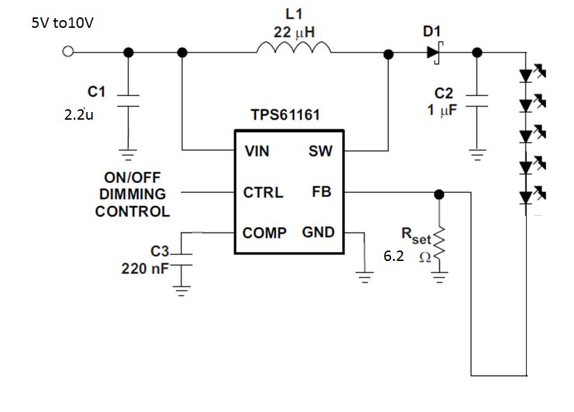

Our customer confirmed the operation like pulse skipping at low PWM duty as inserted. Does TPS61160 have pulse skip mode?
