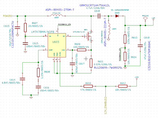

I have a SEPIC design using LM3478.
Input will vary from 5 to 30v and the output must be 18v. Maximum load will be 500mA.
I've used WebBench from TI.
The circuit:
The output has 18v.
But at low loads, for example 4mA, the output is terribly noisy: CA coupled images:
20mA:
I could not find where is the problem.
Can anyone give me some help?
