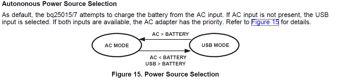

  • Hello Nir,
    Sorry for the delay.
    My first though it that you might be fighting against the input selection subsystem in the device.
    Have you tried letting either the USB or the AC pin float therefore only having one connected? There should be nothing wrong with the ISET resistor you have chosen so lets work to isolate what else could be causing the problem.
