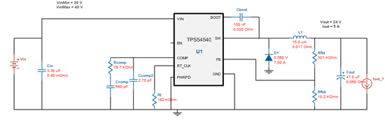

Hi, I am currently using the TPS54540 with a 36V input and a 24V output. I have been having issues with the EN pin, specifically that it outputs a voltage (~6-8V). I want to enable the IC directly from a 5V source, but when they are connected together the voltage to the other circuit the 5V goes to rises. When the 5V source turns off and in turn is supposed to turn off the IC, the IC stays on. The 5V supply has a capacitor on it to keep the circuit going for a few seconds before shutting off completely, so my question is why is the enable pin being so stubborn? I managed to get the circuit to work by placing a diode in between so that current can only go from the 5V source to the enable.
Any help would be appreciated.
