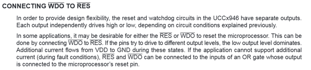

need a watchdog timer which generates RESET when no input signal is asserted in the watchdog timeout (see the figure below).
Is the ucc2946 device – can it be suitable forthis requirements?
In this device the timeout is [25*Cwp], and when the capacitor Cwp is 1uF, for instance, then the timeout is 25 seconds (which the external counter we use will multiply by 12 to get 5 minutes).
Can we use this device with such a capacitor?

    Correct me if I'm wrong but by my understanding you want a watchdog timer that asserts a RESET signal if no signal is detected from the microcontroller within the watchdog period. If so, the UCC2946 is capable of doing this if you AND the outputs WDO and RESET together. From the datasheet:
    You can use the device with that large of a capacitor if the leakage current of the capacitor is well below the current source that is used to charge the capacitor (400nA typical). I would suggest that the leakage current should be at most 1/100th of the charging current so around 4nA or less. This will serve to minimize accuracy problems and instability problems of the watchdog timer.
    The accuracy of the device for the timeout periods will depend heavily on the output capacitor used and the layout of the board, and resistance in the path to the capacitor will reduce the accuracy, along with the leakage current of the capacitor. A rough estimate of the accuracy can be found in the datasheet specifications. Given all of the test conditions, it has a timer accuracy of 30%, but again this accuracy will vary based on a number of conditions.
