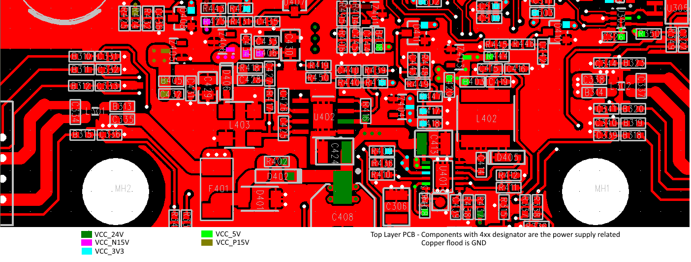

  • Hi Tim,
    Thanks for your reply. I do have another problem that I am hoping to get your assistance in solving it.
    Attached is the schematic of the LM5017 and the other regulator that I use on the prototype board.
    The problem I have is that this arrangement is somehow affect the other regulator that generates 5V and 3.3V, causing the 3.3V output to turn ON again during turn off period. I suspected that this topology is what causing this issue as the problem disappeared when LM5017 is turned OFF (refer to scope measurement attached). The strange thing is that the output of the 3V3 regulator (LDO) somehow is higher than the input (5V) which does not make any sense.
    I have tried turning the LM5017 OFF (by taking out R415 - hence disable the LM5017) and then the issue disappear in the other regulator. Because there were no problem with U401, I suspect that the turn off issue was caused by LM5017; especially because the topology used here is unique.
    I suspect that because the switching node is now connected to Ground point that is connected to the other regulator, this causes the misbehaviour I see in the other regulator. Would you agree or is there any other possible reasons on why the other regulator turns back ON?
    Thank you for your help.

  • Hi Samuel,
    It's a good idea to connect a filter capacitor from the 24V input to the -15V rail (RTN of the LM5017). Perhaps you can send the PCB layout for review.
    Tim

    Please find the relevant part of the PCB layout below:
    Samuel
  • Hi Samuel,
    We typically recommend a solid GND plane on layer 2 (inner layer 1) immediately below the power stage. The capacitor as recommended carries provides the high frequency current for the MOSFETs and is thus connected from high-side drain to low-side source (i.e. VIN and RTN pins of the LM5017). For more information on PCB layout, you can review my EDN article series at this URL http://www.edn.com/design/power-management/4439695/DC-DC-converter-PCB-layout--Part-1.
    Tim
  • Hi Tim,
    As you can see in the PCB layout I attached in the last reply, Inner layer 1 is GND plane and placed directly below the switcher. I have also followed the recommendation of putting any decoupling capacitor close to the pins (i.e. C424 placed close to U402 RTN pad, C425 close to the BST and SW pin, C426 close to VCC pin)
    The only direct connection between LM5017 and the other switching regulator is the UVLO pin that connects to 3V3 and the GND connection (as being -15V output) although when I tried to connect the UVLO pin direct to the input voltage (VCC_24V), the 3V3 rail turn on again like shown in the scope capture before.
    What I don't understand is how the 3V3 rail (an LDO) turn on again with the input (VCC_5V) is less when the LM5017 is enabled and the problem disappeared when I disabled LM5017.
