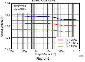

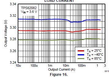

I'd like to know which part does load regulation show on graph?
for example Io=10uA to 1.2A? or 200mA to 1.2A?
Other device is called PWM mode.
Could you please current point on spec condition?
Thank you and best regards
K.Narisawa
The -0.25%/A spec refers to a typical value of either the TPS62081 or TPS62082 devices from no load to 1.2A load. The point is that 0.25%/A is very small--the load regulation is insignificant to the total accuracy.
