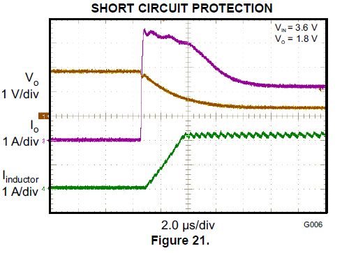

Dear TI
When short-circuit protection works on TLV62566, internal FET is turned ON?
It seems current goes through in inductor even if happen short-circuit protection.
Thank you and best Regards
K.Narisawa

TLV62566 has low side valley and high side peak current limit. It is cycle by cycle, so the inductor current can remain high as shown.
