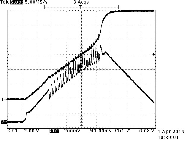

Based on very recent TI recommendations, we've eliminated the dV/dt MOSFET gate drive approach originally being used.  Not surprisingly, an oscillation is observed on inrush ramp-up, arising when the Vin DC supply enters CC mode at 2Amps with the inrush limit set to 10Amps.  When the supply is driven into CC mode as the MOSFET current slews up, Vin momentarily drops below the EN pin threshold, rapidly shutting the MOSFET down.  EN serves as the UV monitor for Vin through a divider network per the TI example application. When Vin recovers and again crosses the EN threshold, the MOSFET current slews up rapidly, repeating the cycle. The intentionally thin decoupling on Vin permits a short cycle time, observed to be around 6.2kHz.  This clearly demonstrates that the inrush current needs to be carefully chosen with respect to the capabilities of the source, and for hot insertion applications, the design needs to ensure the controller is enabled only after insertion is mechanically settled, requiring more than a simple divider network on EN.
What was unexpected, however, was that the TIMER pin exhibited similar oscillation on its rising slope, displaying rise/fall edge rates that defy explanation by the functional block in the datasheet (Figure 5).  When the MOSFET shut down by EN, the TIMER cap discharged by about 200mV with a current far greater than 10uA.  When the MOSFET turned back on, the TIMER cap voltage also rapidly recovered the 200mV drop, somewhat slower than it fell but still far faster than expected from a 10uA charge current.  During this oscillation event, which lasted through much of the Vout risetime of around 6-8msec, the overall slope of the TIMER pin voltage remained monotonic but shallower than the normal linear ramp, roughly doubling the timeout limit.

    The TIMER does have the 2x 10uA current sources which are active in normal TIMER fault modes. The TIMER pin also has a 4.5mA sink current (2mA minimum) which becomes active when the EN pin is below the turn off threshold. So, for your case the ON-OFF-ON interaction between the VIN supply and the hotswap (and load) is causing the EN to cycle above/below the threshold, activating the 4.5mA sink on TIMER momentarily. This will cause oscillations on the TIMER pin.

    Thank you for revealing some innards of the device that aren't described in the datasheet (or perhaps, only described implicitly).  I'm still a bit puzzled however, since the hidden 4.5mA current sink is just a sink. The waveform oscillation I observe on TIMER rises far faster than 10uA source could achieve, as you can see in the inserted capture:
    In the capture, channel-1 at 2V/div is Vout, channel-2 at 200mV/div is TIMER pin with a 47nF ceramic X7R capacitor to GND.  From your description, one expects TIMER to exhibit a downward stairstep waveform with very little positive recovery when the 4.5mA sink shuts off.   Since Ct is ceramic, I'm tempted to speculate that dielectric absorption accounts for the recovery, but the rise is nearly 200mV, far more than expected from class 2 ceramics. Since our design has nothing but a capacitor on the TIMER pin, is there anything else internally that could source mA levels to account for the rise? Looks actively driven to me.
