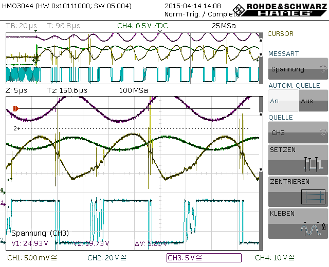

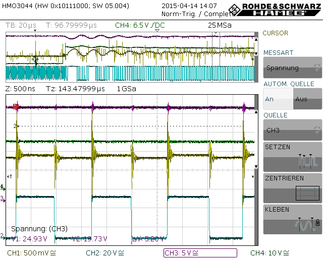

I have a Problem with the DcDc-converter, when I do a load jump from 0A-2A@Vout=24V [Vin = 44V]
I use the compensation Network which is calculated by webench, but the result you find attached.
I describe the different colours :
green : Load jump
Violet : Vout = 24V
yellow : comp Pin
The first Picture Shows the unstable state and the second the stable state.

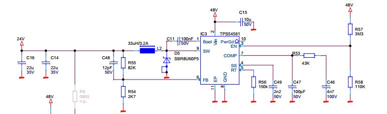

Third Picture is the Regulator with all components.
What can I do to stabalise the Regulator ?
Kind regards
blue : Switch
  • What is the difference between the first and second waveform? Just zoomed in to a different time? Bottom trace is the SW node correct? It appears to definitely be under damped. If you have large transients with fast slew rate you may also need more output capacitance.

  • I do different measurements, maybe the risetime of the load current is a little bit different.
    The first one didn't stop swinging, althoug I Change the load.
    The second one stabalise the Output after a few µs.
    Bottom (blue) is the Switch node, yes.
    One question regarding the Switch node. I thought, that I have a fixed frequency, only the on time of the Switch varies.
    In the datasheet I didn't find this state, that the mosfet in "on" for such a Long time. Can you explain me what happens inside the TPS54561 ?

  • Hi Cristoph,
    Do the output capacitors on your schematic match those recommended by WEBENCH? I put your requirements in and the recommended output capacitance is 2x 47 uF but your schematic has 2x 22uF. The compensation network is also about the same as yours. Using different output capacitance than recommended by WEBENCH could cause the circuit to be unstable.
    Anthony

    First I changed the output capacitor in webench and yes, the system is instable.
    Second, increase the capacitor in reality and the Regulator is stable.
