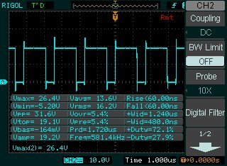

    The main reason of all this questions was to solve my noise problem.
    Let me attach some images:

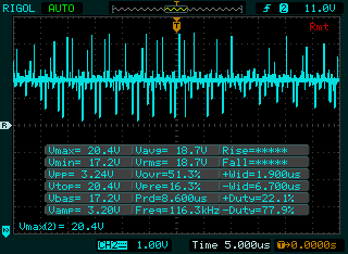

    This is my PH node. DC coupled with 0 DC offset
    This is my PH node AC coupled
    This is my VIN Pin (Righ now comming from a lab DC source) Viewed with -17Volts DC offset

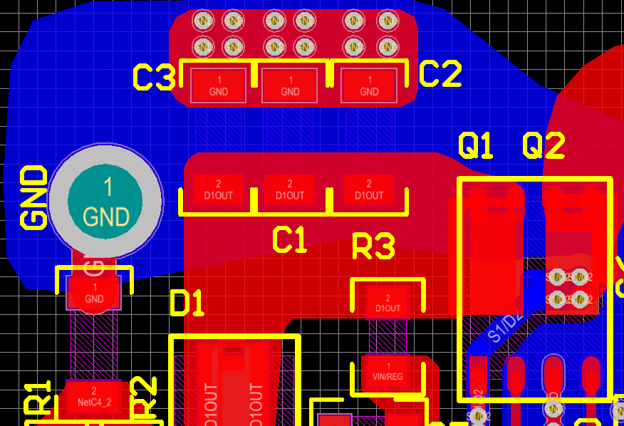

    And finally, this is my PCB layout for my input capacitors
    Due the noise I though of placing a snubber.
    I have been playing with input capacitors to reduce the input noise but haven't come up with any good results
    Do you have any recommendations to improve my design? Righ now the system is charging the battery, but of course, for a stable design this noise has to be eliminated.

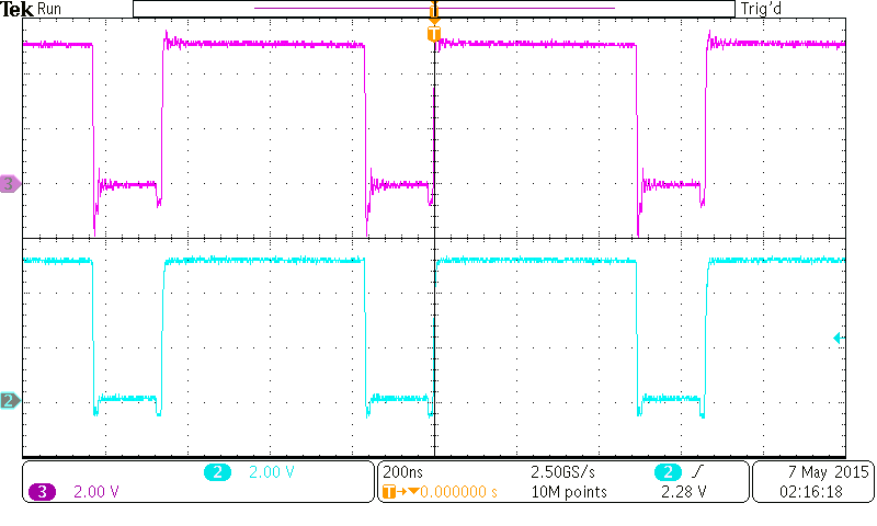

    I think your overall problem may be your measurement method. Are you using proper scope probe placement methods (like tip and barrel, or using scope probe test points as used on the EVM like TP2)? Do not use the ground lead on your scope probe for these measurements because the loop that is created with the scope probe ground lead will pick up the the emitted radiation from the SMPS. See the following app note (figure 6 in the app note) for the tip and barrel method:
    The following scope capture shows the same signal capture using the scope ground wire (CH3) and using the scope probe test point like TP2 (CH2). You can see a big difference in noise.
    It's hard to tell from your layout if the placement of input capacitors is ideal. It's not just the placement of the input capacitors, but how small the AC loop is to keep your noise at a minimum. Make sure you are following ALL the guidelines listed on page 25.

    I'm using the probe test that my humble Rigol DS1052E provides
    The TP2 tip right now is far from my hands unfortunately to implement it on my already fabricated PCB. Will include in the ver3
    Its curios because I have the EVM and have tested the same points from where I'm getting noise.
    And the signals in the EVM look clean even though I did used the GND clamp in junction with the probe (Contradicting your suggestion)
    Still, by the facts that you mention I might be measuring wrong. What other methods can I use to test the TRUE signal?

    The amount of noise you pick up through your scope probe ground is also heavily dependent upon layout. The EVM layout is optimized (by keeping the AC loop as small as possible) which is why it doesn't generate as much EMI as your own layout might. You can also get a short ground lead by wrapping a metal wire against the metal exposed ground of the scope probe (see the following image): www.cliftonlaboratories.com/.../Update202.jpg. Retry taking the plots again with this method to see if the measurement gets any better.

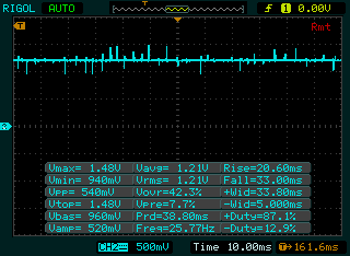

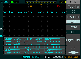

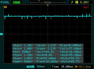

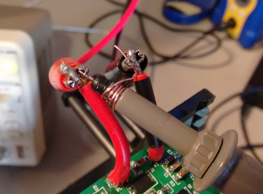

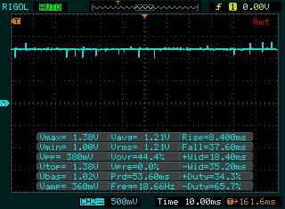

    Regarding the measuring method, I had taken this shots and you are right. Having a small ground wire reduces significantly the noise
    MPPT pin with normal measure technique. Long ground cable
    MPPT pin with short ground wire
    VFB with normal measurement technique
    VFB with short ground wire
    One point to view is that the VFB pin had the 22pF cap and the MPPT pin dont.

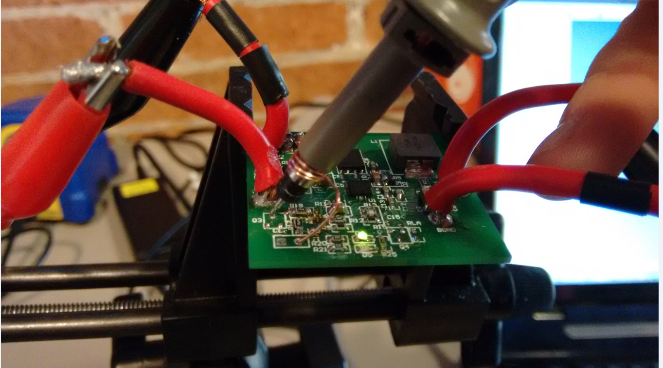

    This is how I measure the different pin
    Measure on MPPT pin
    Measure on VFB pin
    Tip configuration

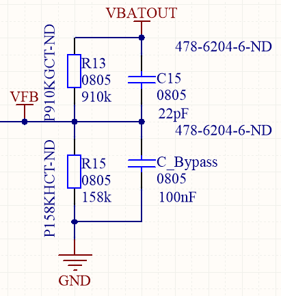

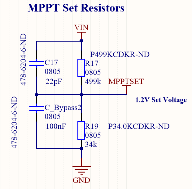

    #11. Ok, Will do that. I will try adding this configuration for my next iteration. Both MPPT and VFB pins. Will you have a comment on this 2 capacitor / filter array?
    Take a look of my proposal
    For MPPT
    For VFB
    #12. Above are the scopes of the pins. I think was probably because of the measurement methods. When you say the capacitor on VFB, you mean the 22pF in junction wiith the battery node? Thanks
