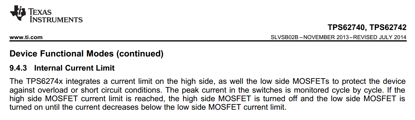

i'm working with tps62742
in the datasheet , there's a description about overload and short-circuit protection of this IC , but it's not about how this protection work (time,threshold...)
could you tell me how this protection works?
