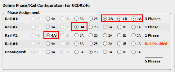

  • I think there was an error in your initial question (which I corrected), it indicated UCD9224 with CSD95372 in the Xilinx Ultrascale reference design but the PMP9475 uses the TPS40428 with CSD driver/mosfet stages.
    UCD9246 would be the correct offering if you were looking to control the three rails with one controller, it can control up to 4 rails with up to 6 phases. The 60A rail would likely consume 4 phases (3 used, 1 leftover) then each of the other two voltages would consume 1 phase.
    UCD9248 (4 rails/8 phases) may be required if you ever needed to increase the current of the 20A rail much higher as the leftover phase on the UCD9246 (from the 60A rail) could not be used with the single phase rails (A and B phases can not be split between rails).
