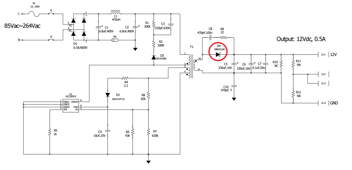

A schottky diode replacement question on PMP4447
My question is regarding PMP4447
The BOM (http://www.ti.com/lit/df/tidrco3/tidrco3.pdf) defines the D4 as "MBRS3100, Diode,Schotty, 3A, 100V". Here is the data sheet of the diode.
The transformer's secondary side is rated as 12V, 0.5A. Would it cause any problem to replace MBRS3100 with "MBR2H200SFT1G" (datasheet) 200V, 2A which is smaller and cheaper?
