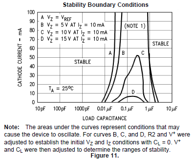

Hi Team,
My customer considers to use LM4041-N.
Is there stability boundary conditions like the following LM431(datasheet page.5)?
I believe LM4041-N is ensuring stability with any capacitive load so there isn't the same figure, but would like to confirm just in case.
