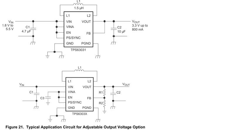

Hi team,
We have a question about VINA pin.
2 reference designs in datasheet are different that the one for TPS63031’s VINA should pull high.
On the other hand, TPS63030 VINA and EN series capacitor to GND.
Could you let me know which one is correct?

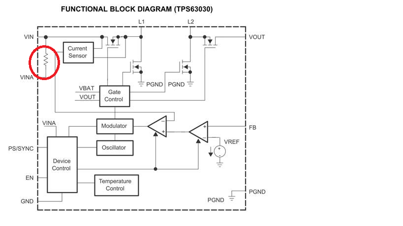

Could you let me know whether that capacitor is with arrowed resistor as filter and what value for that resistor?
In my acknowledgement, if VIN pull high, that resistor becomes useless. Am I right?
Is the resistance inside IC for R-C filter?
What resistance for that?
Thanks.
