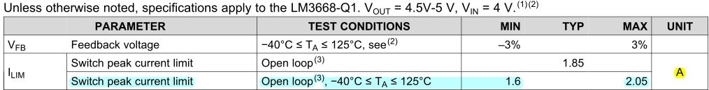

    Please answer following additional question about “Switch peak current limit, min”.
    Customer wants to confirm margin of “Switch peak current” when Vin=3.3V and Load current= 660mA.
    Datasheet has following “Switch peak current limit, min” specification when VIN=4V.
    Please advise if current limit minimum 1.6A is decrease or increase when VIN=3.3V, and how is amount.
    Best Regards.
  •  Hi,
    If input voltage drops, max SW current will also drop. Max Iload was set based on measured value from the validation and sim result.
    There is a equation on datasheet to calculate Isat(inductor current) also shown above.
    The calculated Isat for Vin=4V, Vout=5V, Iout=1A condition is 1.341A. Iswmax should be bigger than this. 1.6A is ~20% bigger value than Isat value.
    In same way, Isat for Vin=3.3V, Vout=5V, Iout=0.7A condition is 1.188A, then adding 20% of this, Iswmax will be ~1.42A or little less.
    Sorry, there is no measurement data for all voltage/load conditions available.
    Hope this helps.
