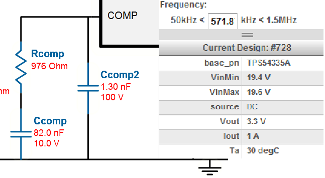

Our customer calculate the loop compensation component(Rcomp , Ccomp , Ccomp2) using “WEBENCH of TPS54334A”.
(I received advice from John-san.)
https://e2e.ti.com/support/power_management/non-isolated_dcdc/f/196/t/440509
However, "Result of datasheet" does not accord with " Result of WEBENCH".
Could you please let us know if you know the reason?
And, Which is result most suitable?
[Our customer’s conditions]
-Vin=19.5V(typ)
-Vout=3.3V
-Iout=1.0A
-fsw=570kHz
[Result of WEBENCH]
-Rcomp=976ohm
-Ccomp=82nF
-Ccomp=1.3nF
[Result of datasheet]
-Rcomp(R4)=6.676kohm
-Ccomp=23.23nF
-Ccomp=0.02nF
Kanemaru
  • You weren't actually expecting to get the same results were you? Webench and the datasheet use two different methods (actually 3 different methods if you include the method of section 8.4.5 small signal model for frequency compensation and section 9.2.1.2.6 compensation components. I prefer and recommend the method of section 9.2.1.2.6. It is what I personally use. I suppose they are all valid, but I think pspice modeling is the most accurate, followed by webench and lastly the simple model of section 8.4.5
