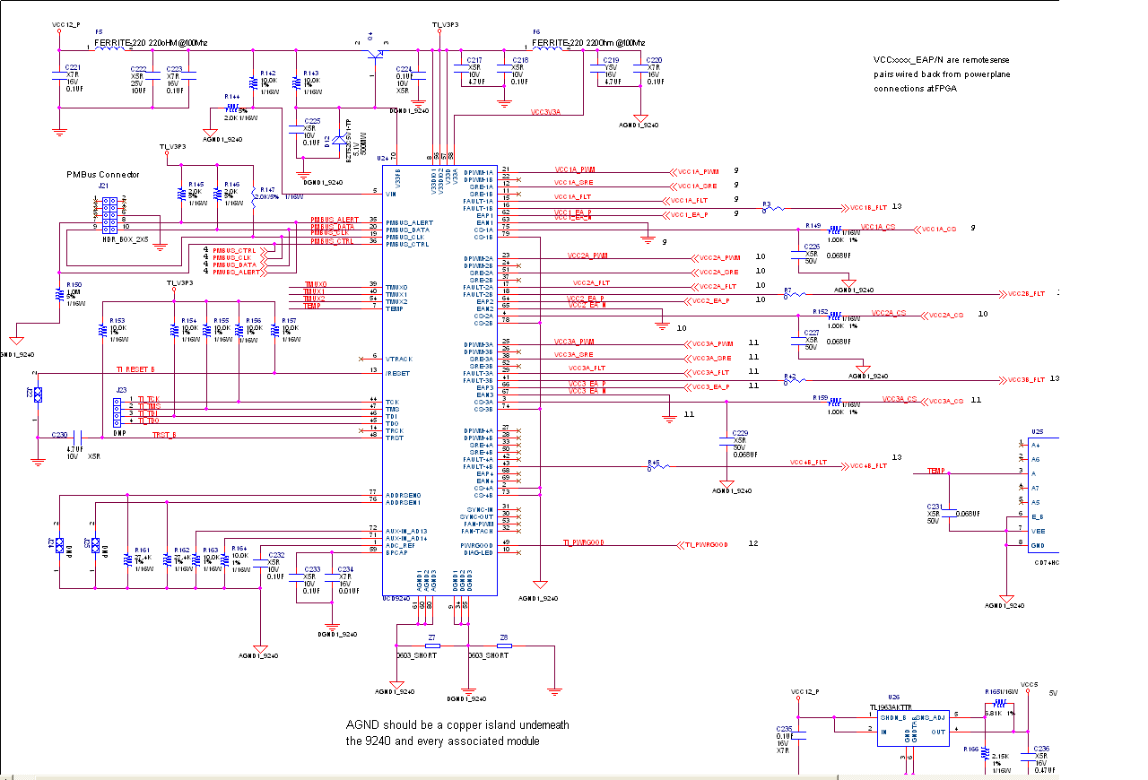

I have a trouble to use the power module PTD08A010W that is controlled by UCD9240.
I've tried to make a PCB board with a power circuit as below.  It refers to a Xilinx SP605
demo board.
I, however, can not get any output voltage at the output of PTD08A010W.
I've tried to measure the circuit.  I can get a result as below.

In addition, I've one question about the TRST, In spec, it recommend to connect it to ground with 10K ohm.  But our reference is connected it to TI_V3p3.

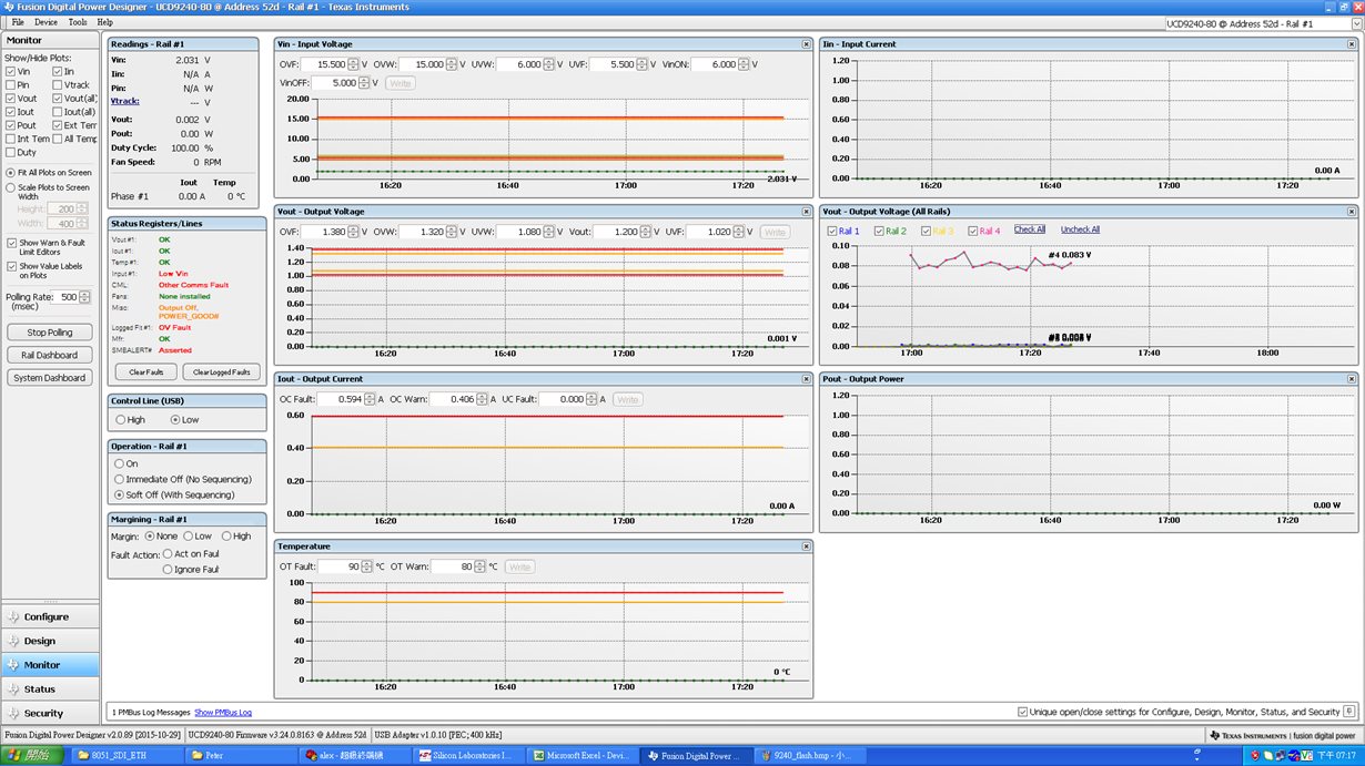

    Did you import project file into UCD9240? If so, in the project file, if the rail's On/Off Config is CONTROL Pin Only, the PMBus CONTROL pin must be asserted to turn on the rail. You can also set it to Always Converting, then the rail will automatically start.
    If the rail still does not start, connect UCD9240 to Fusion GUI. In the Monitor page, you can see if there is any fault occurred, such as Low Vin, OV, OC, etc. You can capture waveforms of switching node and output voltage, and find out what happened.

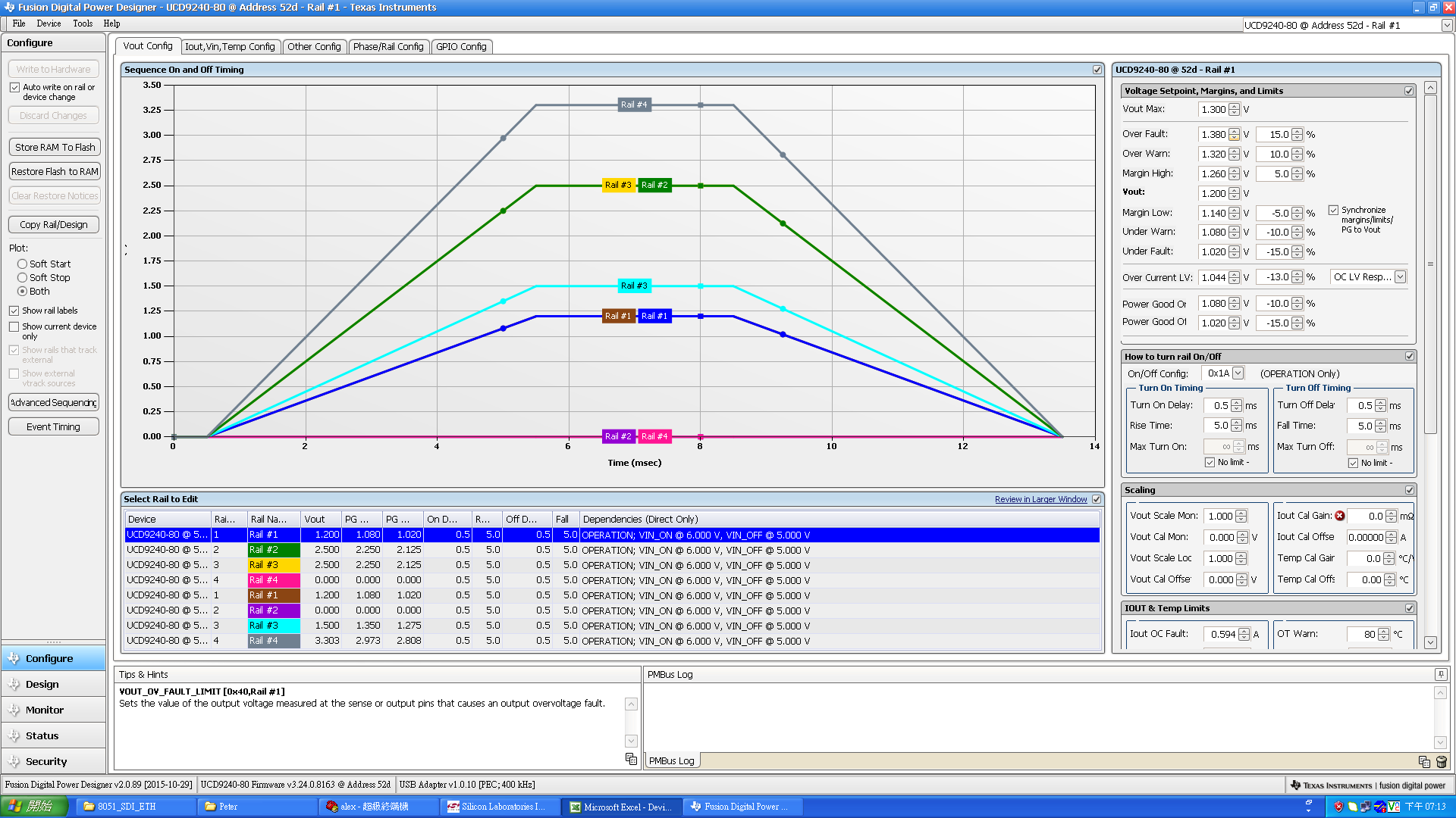

    The UCD9240 device has no configuration out of factory. User must program configuration into the device. If you are using the exactly the same design as EVM (same inductance, same output capacitance, same sequence), you can use the project file provided along with the EVM.

    After getting a USB to GPIO cable, I've tried to write configuration data into the flash as the attached file.
    It seems successfully programmed.  But I can get any voltage on the Vout.
    I don't know why?  How to check?  Thank you in advance.

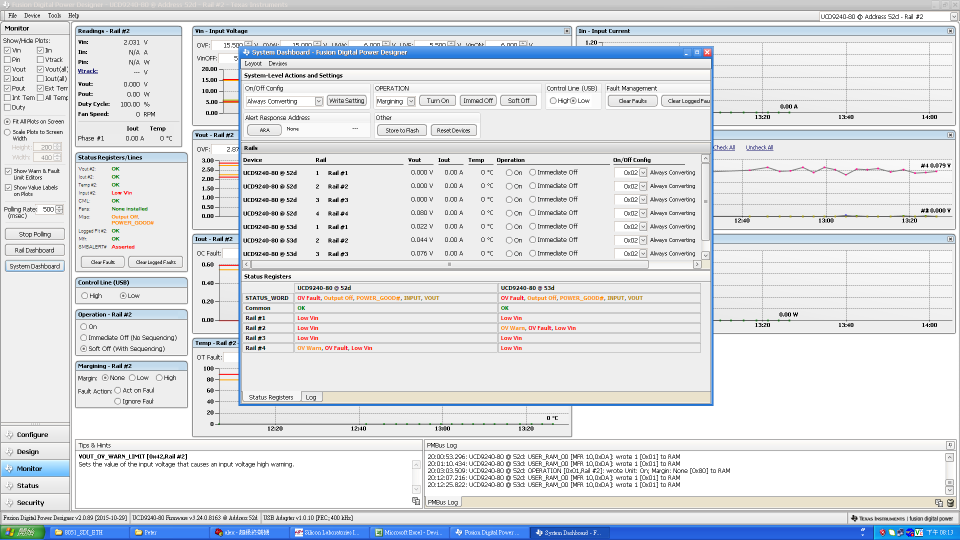

    One more information as below about the system settings.
    Have I turned both chip on?
