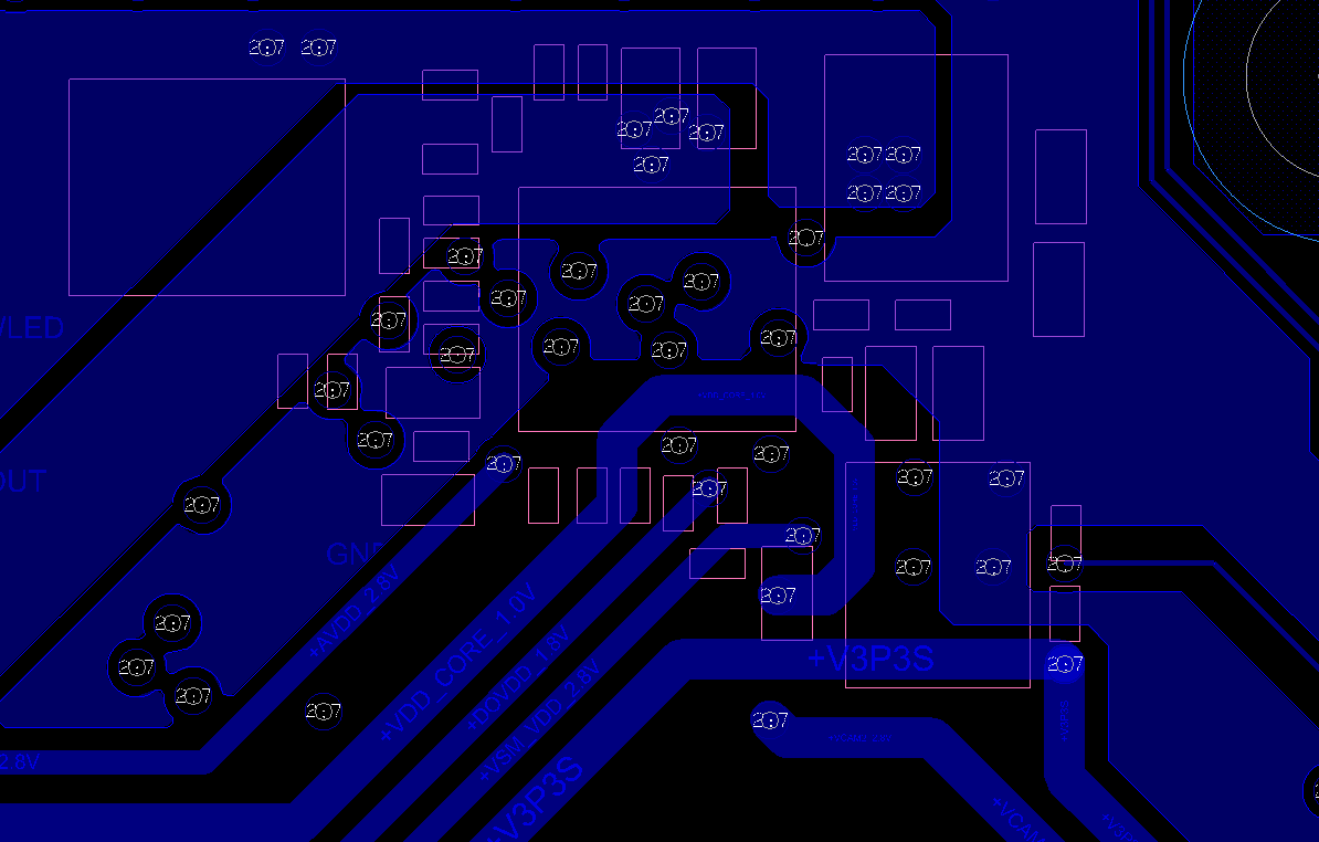

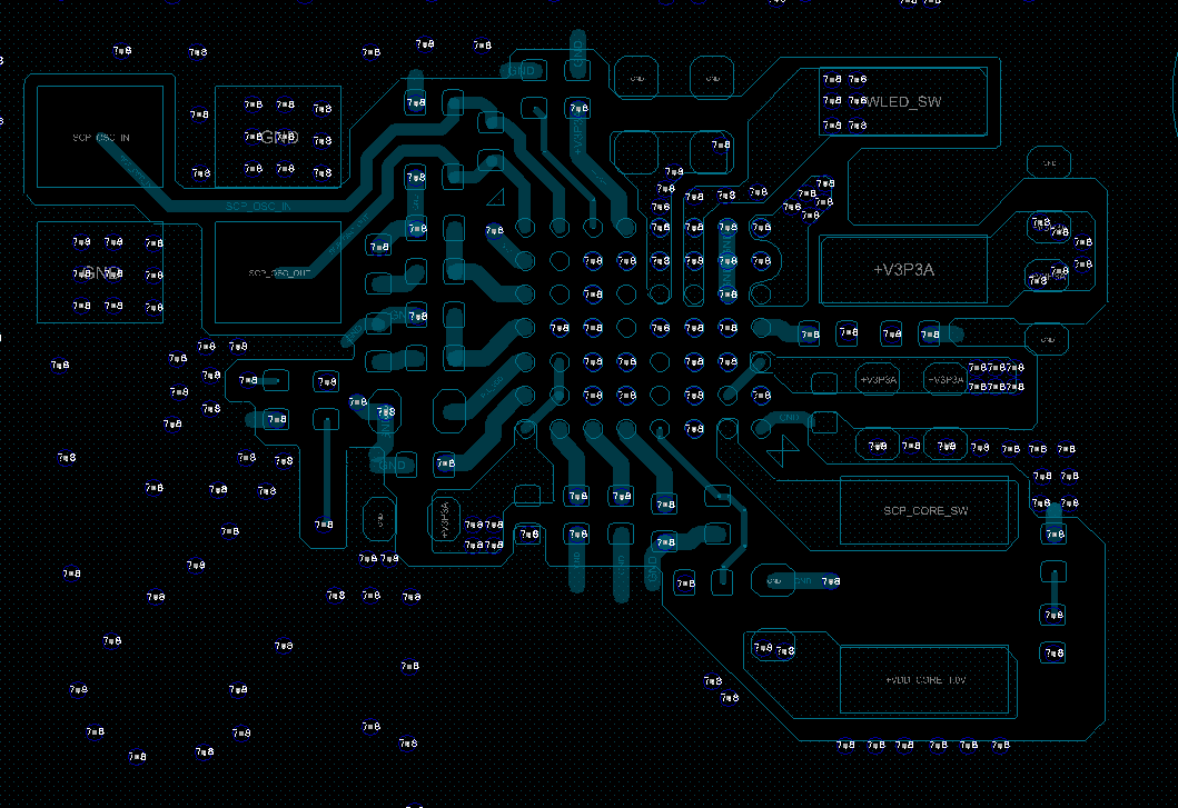

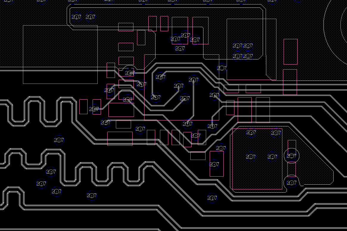

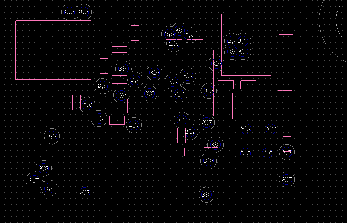

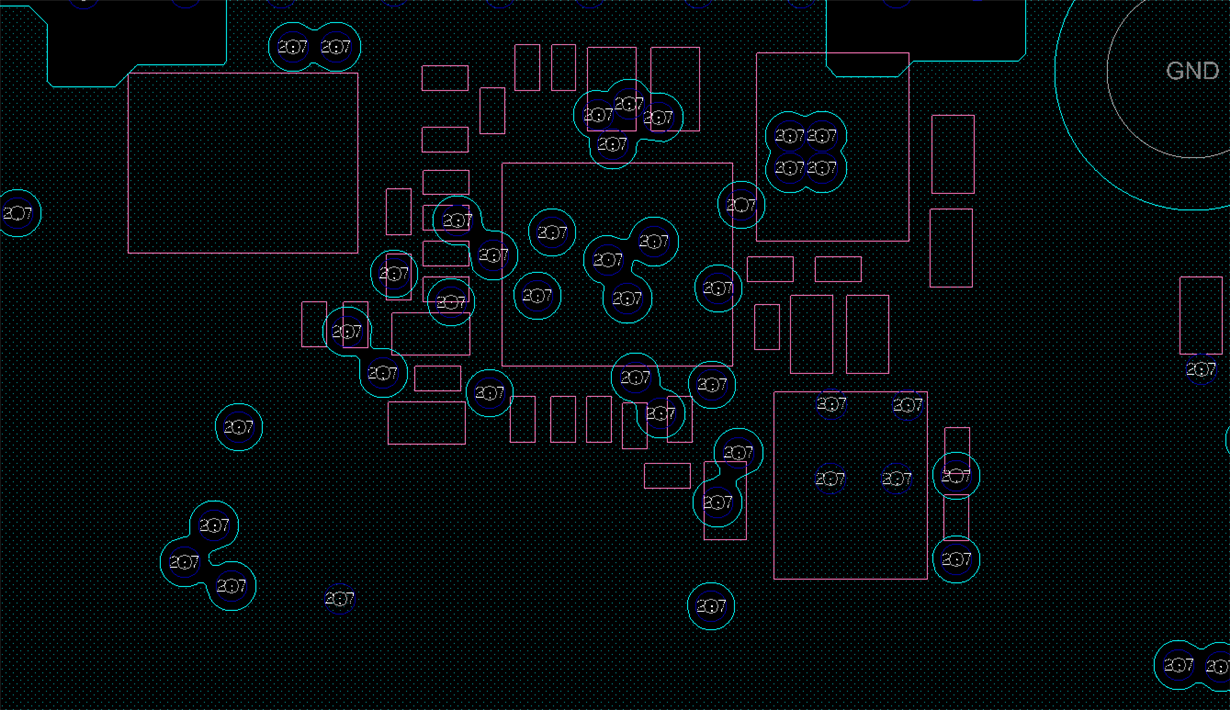

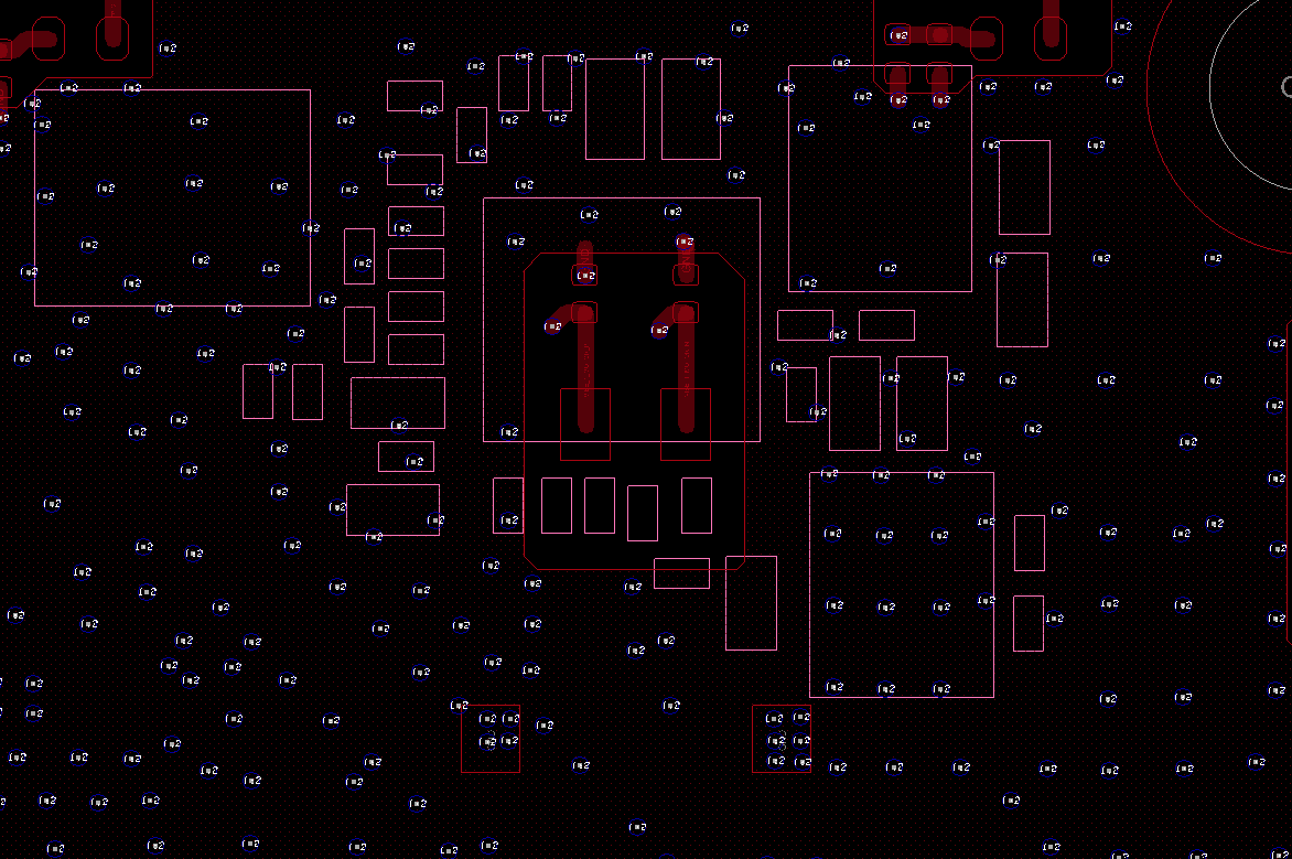

Hi TI friends:

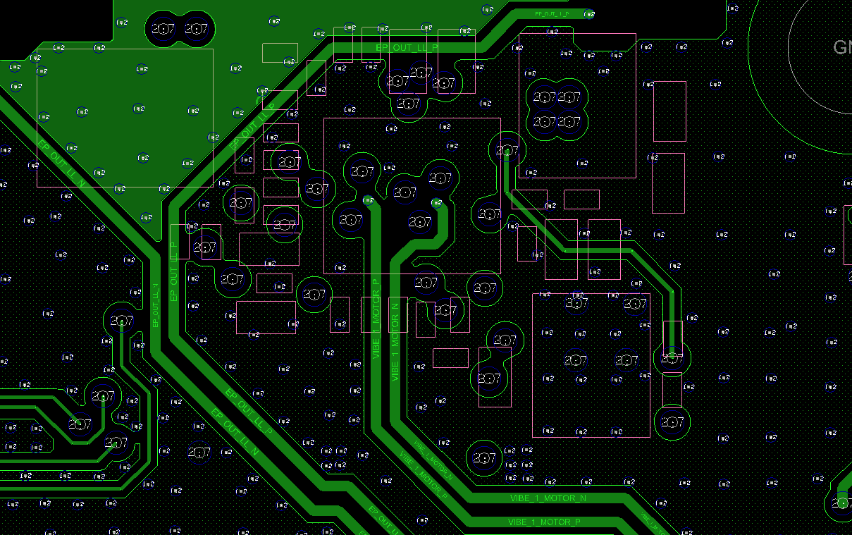

     would you please help to review the Layout for  TPS68470 in our new project, hope below captures are enough, any question, please let me know, thanks.
Bottom layer:
Layer 7:
Layer 6:
Layer 5:
Layer 4:
Layer 3:
Layer 2:
TOP layer:
  • HI,
    I did a quick look through and see that the PGND of the boost converter and CORE buck are not directly connected to the CIN caps of the respective rails. The PGND balls must be directly connected to the CIN, preferably on the same layer as the IC.
    Please see section 11.2 layout example in the datasheet for an image representation of what I am referring to with the PGNDs.
  • Hi Michael Green:
    Thank you very much for your review.
    Due to the shield of the camera PMIC is very small. I think there is no enough room for better placement. please refer to capture below.
    And the PCB had  tapeout a few days before.
    Could you please tell me what issue will be caused with the current layout. thanks.
    If the PGND for the boost and buck are not close the caps or if the loop is lengthy then high noise may be emitted either on the board or surrounding area. Watch for this during your EMI testing. Second, you may see VIN dropouts which could cause Vout over and undershoots / noise. However, if the drop out is bad enough you could cause dropouts on the Vout. You should conduct Iout transient testing at the minimum input voltage to check for the second point of concerns.
