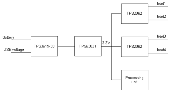

  • Thanks for the reply and additional information. Sorry about the confusion on the SW waveform, I should have clarified especially since this part has two different switch nodes. It would be extremely helpful if you could provide us the following:
    1. Full layout and schematic of the board. We are particularly curious about how you are providing power to the board, location of the output capacitors, component values, and how you are turning the microcontrollers on/off.
    2. Switch node waveform from both pins L1 and L2. To get this waveform solder some bus wire onto either side of the inductor and measure both on seperate channels. If we could see two full switching cycles and setting it at 1V/div should be appropriate. Both L1 and L2 can be on the same plot.
    3. Vin waveform. AC coupled at 50mV/div.
    4. If possible, the inductor current, but the probes resolution will probably make this measurement not very accurate. This would be more useful for a general shape rather than a precise value.
    After reviewing your initial post, I wanted to clarify about your current consumption. Where are you measuring this value and how are you going about doing it? Also, have you tried testing it at 3.0 and 4.2 Vin yet?
  • I'm afraid I cannot post here the full layout nor the schematic of the board. Attached, though, you can find the block diagram of the power management block.
    During sleep, normally only the processing unit receives voltage. You can ask me more details if you need. One thing that I noticed about the schematic, is that I haven't used two 10uF output capacitors but only one. Is this a problem?
