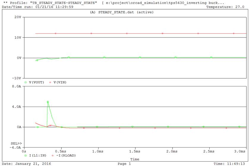

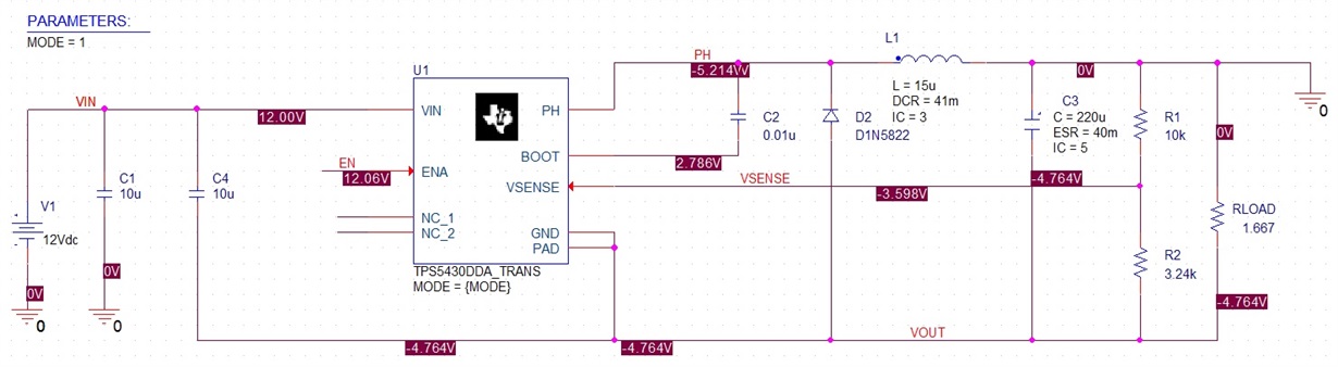

 I want to apply the TPS5430 in my application which converted +12V to -5V. then TPS5430 PSpice Transient Model had been downloaded from TI website(http://www.ti.com.cn/product/cn/TPS5430/toolssoftware), and modified the schematic as shown below. It is same as TPS5430EVM-342 2.25A Inverting Buck Boost Regulator Evaluation Module. But it is doesnt work, could you please help me about this problem. Thanks in advance.
The simulation result as shown below
